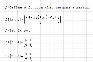

Here's a function that returns a matrix. I didn't say it was a useful function.
funny matrix function

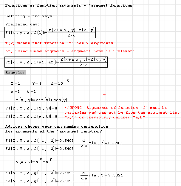

Besides variables, function can have another function as an argument. Here is an example:
function as function argument
