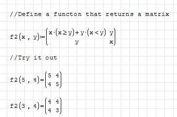

Here's a function that returns a matrix. I didn't say it was a useful function.
 funny matrix function |

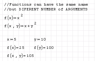

On the RHS is the function definition by an expression. As one can note, functions can have the same name, and are distinguished by different number of arguments like
f(x,y)-two arguments,
f(x)-one argument. Even

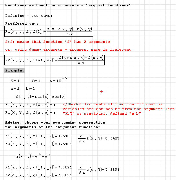

Besides variables, function can have another function as an argument. Here is an example:
 function as function argument |

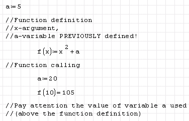

Shown below is a common mistake:
 common mistake |

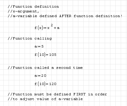

Explanation: The common mistake shown above is avoided if the function is defined first. The variables should be assigned to their desired values only after the function is defined. Smath (like Mathcad) calculates from the top-left corner towards the bottom-right corner of the worksheet; therefore, if a variable is defined and then a function is defined using that variable, Smath defines the new function using the previously assigned VALUE of the variable. Changing the variable lower on the worksheet cannot redefine the function because the function was defined higher up on the worksheet. Therefore, if the user wants to be able to edit variable values used within a function, the function must be defined first using previously UNDEFINED variables and then the variables can be defined (and redefined as many times as desired) lower down on the worksheet. See graphic below for correct usage:
 correct usage |
EditFunction Overloading
 Functions can have the same name |

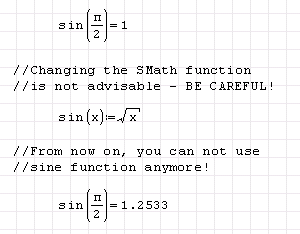

EditReserved Words
 Reserved words? |
 Redefining SMath function - take care! |

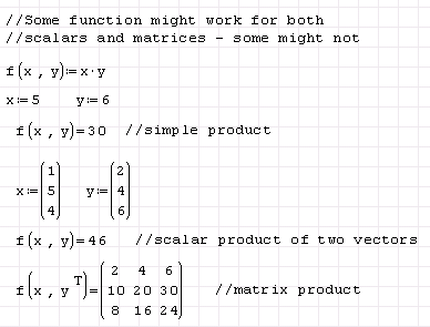

EditArguments as Scalars or Matrices
 Scalar? Matrix? arguments |

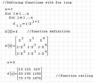

EditDefining Functions with 'for' Loop
 Using for loop |
