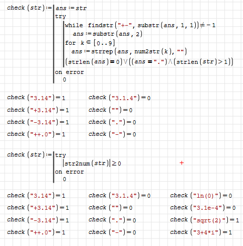

Hi. This could be a way for positive numbers.
check.sm (4 KiB) downloaded 54 time(s).

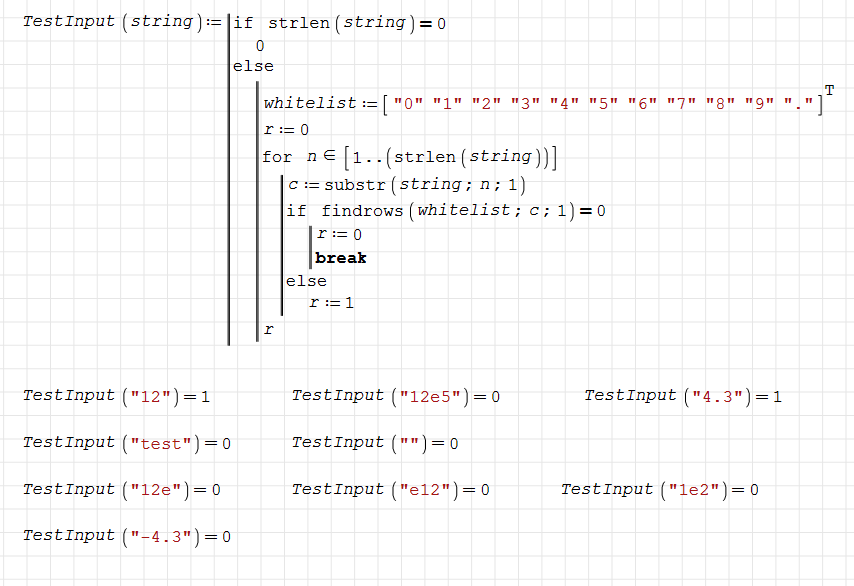

Here is a less compact solution, can be adapted to accept different characters.
(Positive/negative values can be allowed with an additional condition on the first character)
test_input.sm (12 KiB) downloaded 65 time(s).

Signed numbers allowed. Also, compared with str2num results.
check.sm (12 KiB) downloaded 65 time(s).

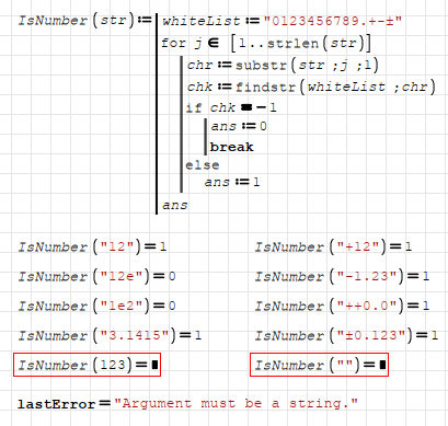

Near identical to Davide, this is how I would do it.
At least this is what I have done in QBasic long ago.
IsNumber.sm (7 KiB) downloaded 67 time(s).

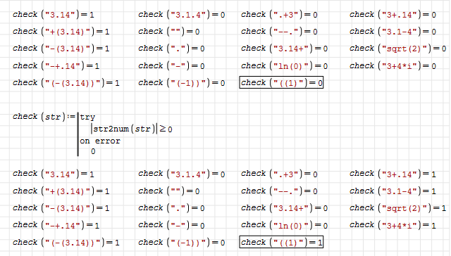

Hi. Parenthesis added. Notice that the plus/minus sign must to be only at the first's places, but with parenthesis it is not more true. And it looks like SMath's str2num have a bug: str2num(" ((1)" ) is wrong.
Check.sm (21 KiB) downloaded 64 time(s).
