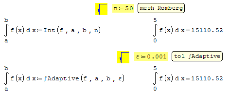

#24 Posted: 12/27/2021 12:32:32 PM
1. as well, you can recast the function name.
That's what I meant by recast, last page of the attached.
Cheers ... Jean.
Integrate AdaptiveRombergKernel FIRST Tool.sm (152.26 KiB) downloaded 1236 time(s).
#25 Posted: 12/27/2021 5:19:04 PM
