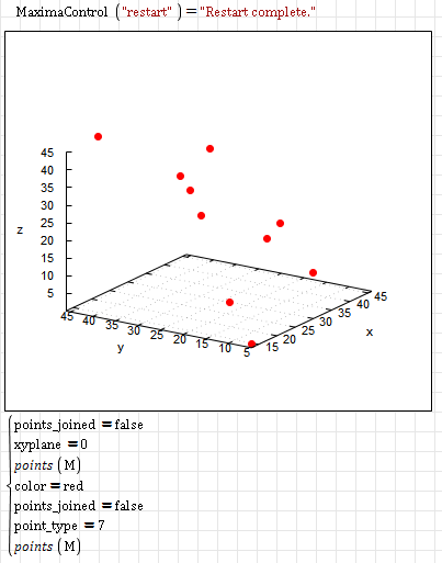

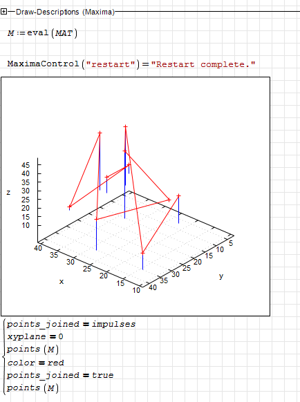

Scatter plots can be made using the Maxima plugin. I didn't respond initially, because the interface has never been tested with 1M points. Yet the backend gnuplot should be able to do that. I just don't know whether there are some limitations in the conversion functions.
The example uses a Maxima Draw3D plot region. You can interactively rotate and resize the plot with the mouse.

If the plot is sufficiently stable, you can remove the restart command.
You also can remove the first occurances of points_joined and points(). I just used them to demonstrate a selection of options.

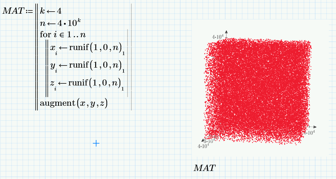

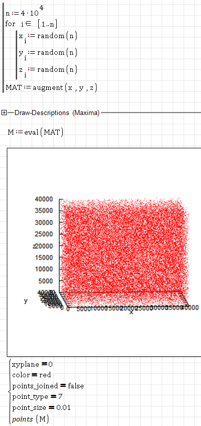

I think that a limit for stability is 40k points. Very difficult to rotate the graphic, but..it is a limit. A normal behavior I will consider until 5k points (to plot in ~5 s and easily rotate).
Again, thank you, because this will help me achieve my program (interaction volume for concrete design). And rarely I will need more than 5k points (I think 1M points was clearly an unthought exaggeration).

SMath (40k points):
Mathcad(40k points): (plotting limit of Mathcad)

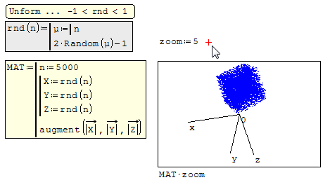

No problem to rotate the graphic ... didn't try 5 k.
All native random in CAS are "uniform"
unless specified [Weibull, Normal, Logistic].
We have those in Smath as utilities.
All modules NUMERIC.

There is another option for Maxima based plots in SMath.
You can use the same list of commands as argument list to the function Draw3D(). You can directly put this command into the placeholder of an Image region. This region displays images given by file name. And not really just by chance, the Draw3D() command returns the file name of the generated image. The drawback is that the image is just be scaled upon resizing the region and can't be rotated interactively.
This is sometimes more stable than using the interactive regions.
For further polishing the plot you can basically rely on the official maxima documentation of the draw package. However, not all options are supported by SMath. The german handbook (section 8.1) gives a good overview of what can be done with Maxima and SMath.
Note that pointsize (and possibly other options) don't account for high DPI settings. 0.01 is rarely visible on 4K.

No problem to rotate the 5k graphic
24 Quaternions possible rotations ...
export the preferred angular system.
Would nice to add the cube outline.
Martin: what can you do with that in native SS 6179 ?
Cheers ... Jean.

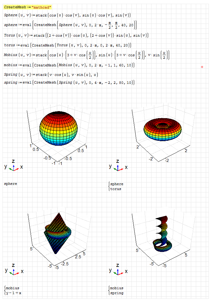

#52 Posted: 8/19/2025 10:32:01 PM
1,558 likes in 1,868 posts.

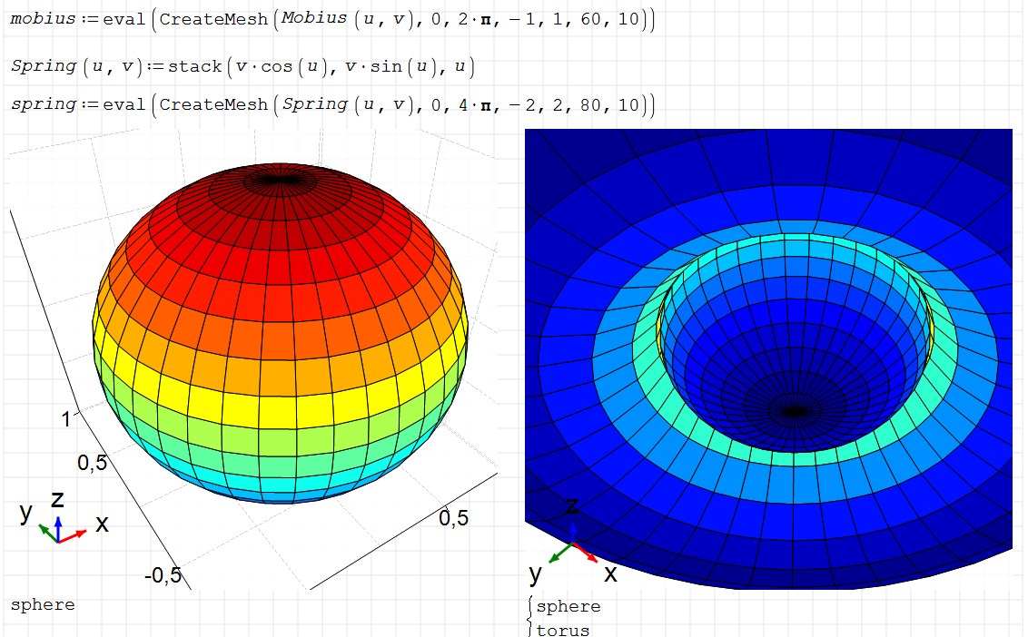

SMath Studio compatibility History page Changes AI Assistant
Plugin updated. [BETA]
It's very difficult to improve this plugin. Basically, I started developing it from scratch.
Changes:
- expression parsing has been improved;
- CreateMesh() function has been improved;
- automatic scaling function has been added;
- surface drawing algorithm has been improved;
- added many bugs.
plot3d-examples-draft.sm (11.38 KiB) downloaded 1370 time(s).
Edited 8/19/2025 11:04:36 PM
