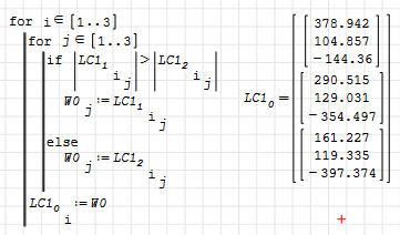

Why does this work:

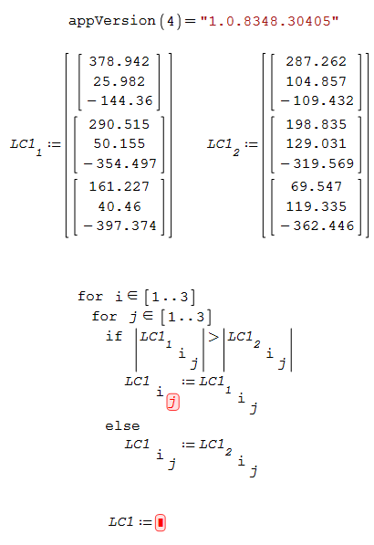

But this does not:
Seems like this should work.
What am I missing here?
Maybe someone has a better way of doing what I'm trying to do?
Worksheet1.sm (9 КиБ) скачан 64 раз(а).

Hi. SMath do not fully support MDA (multiple dimension arrays). This is a way to handle this case
mda-assign.sm (10 КиБ) скачан 68 раз(а).
