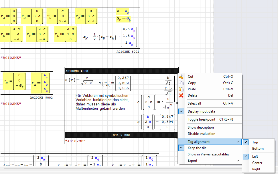

#55 Опубликовано: 25.08.2017 13:11:01
PLUGIN UPDATED (latest nightly build only)
  • fixed missing width/height settings on save/load;
  • plugin made available for SMath Viewer;
  • refactoring;
about SMath Viewer:
context menu now contains a new option "Show in Viewer executables";
if checked a button and a label are added in the viewer executable (default is not checked)
hoovering the button, a tooltip is available; the bottom text can be replaced by your own, using region's description (when available and shown in the worksheet).
clicking the button, a drop-down menu contains the image thumbnail, as well as the export options available in the worksheet.

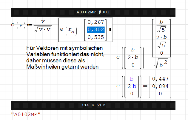

#56 Опубликовано: 29.11.2023 08:06:54
I am using the snapshot region a lot for producing manuals on SMath Studio (see https://extmoodle.th-brandenburg.de/course/view.php?id=138§ion=2). The workflow allows for quick update and corrections.
Regions copied via clipboard to Word or other programs have much better image quality than the snapshots produced with the snapshot region. Here is an example:
Would it be possible to increase the resolution of the screenshots? The clipboard copies seem to have double the resolution compared to snapshots. I'd be happy to have that resolution also in the snapshots.
2-2-neu.sm (133,18 КиБ) скачан 1587 раз(а).
Oscar Campo 29.11.2023 11:00:00, ioan92 29.11.2023 14:11:00
