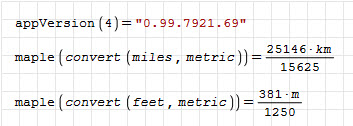

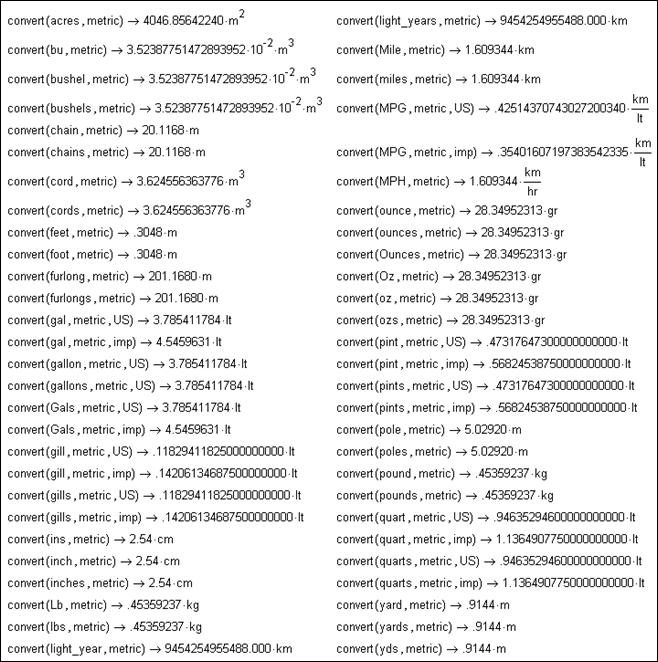

#22 Опубликовано: 11.04.2022 09:47:32
Some support for units is present.
