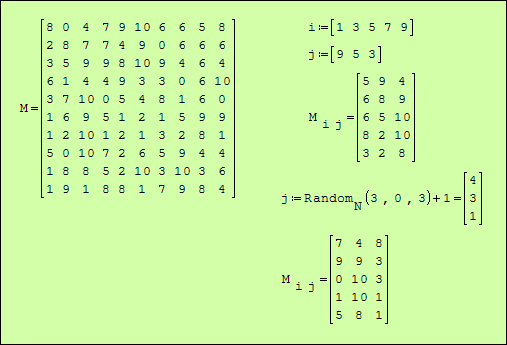

Just seems like it lends itself to manual creation of the vector used in the indices, but I suppose you just need to be creative enough.
... M:=Random.N(10,10,0,10) ... try range [-10,10]
It will fetch the [i,j] submatrix from where they originate,
either manually or else invention like here randomized
#22 Опубликовано: 18.11.2022 11:54:43
... ignore "Cannot find file"
Utilities Matrix Shuffle Random Extract.sm (12,57 КиБ) скачан 1272 раз(а).
#23 Опубликовано: 18.11.2022 12:41:34
... more convivial version.
Utilities Matrix Shuffle Random Extract.sm (18,65 КиБ) скачан 1337 раз(а).
