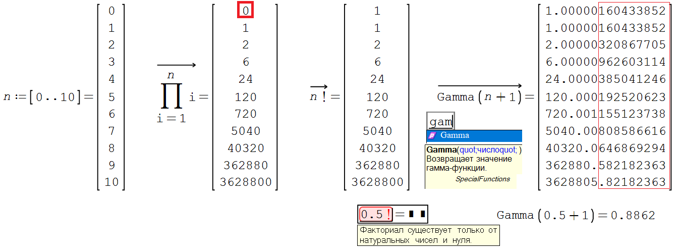

SMath Forum SMath Studio Bugs & Problems Gamma-function 1 Pages (2 items) Gamma-function - Messages Go to last post #1 Posted: 9/19/2024 9:06:29 PM Valery Ochkov 67 likes in 713 posts. Group: User 8-5.sm (6.49 KiB) downloaded 1706 time(s). #2 Posted: 9/21/2024 5:09:19 PM overlord 599 likes in 1,381 posts. Group: Moderator Gamma functions are broken. Not very accurate to be fair.Use sample functions either from myself or from Razonar's.Regardshttps://en.smath.com/forum/yaf_postst20338p2_Gamma-Functions.aspxgamma_r9.sm (36.93 KiB) downloaded 1894 time(s). <- My samplegamma.sm (27.93 KiB) downloaded 1949 time(s). <- Razonar's sample 1 Pages (2 items) New Posts No New Posts
