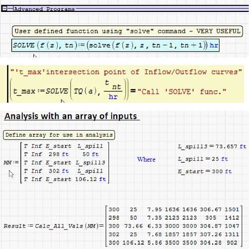

Useful for collecting multiple sets of solutions.
Solve Algo Style.sm (4.97 KiB) downloaded 1045 time(s).
A similar approach used in the attached example.
Small Dams Flood Routing Ex-Program Method-Original-Simple3-R4.sm (1.3 MiB) downloaded 1180 time(s).
