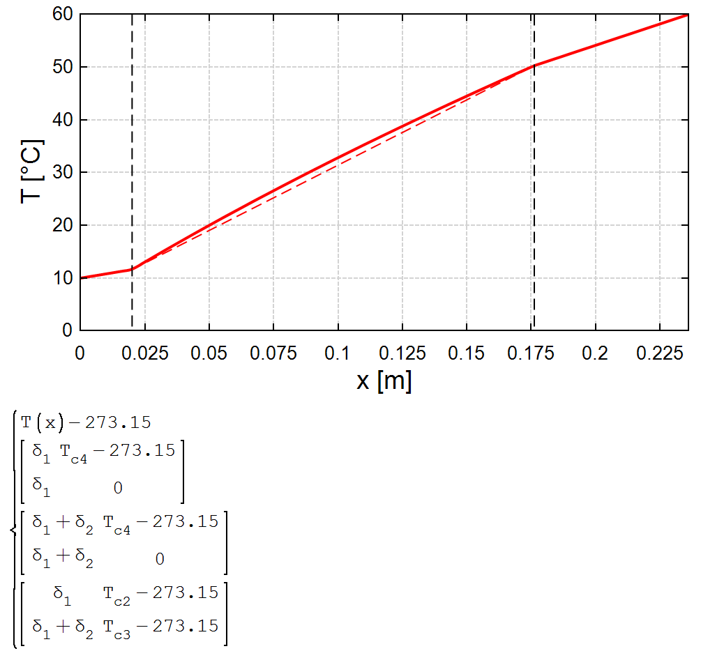

I am trying to plot a temperature field in a three layer wall. There is no problem with the outer layers. But there is a problem in the middle layer - there should be a parabola, not a straight line. How to draw this parabola in the simplest way - with one formula. I know the hard way.

There are so many splines and Bezier interpolations in this forum!
But I don't understand why the connecting line has to be a parabola, because inside one wall layer the parameters (conductance, permeability) are constant so you should have only straight lines. Unless you found a way to have a gradual mix of material!!!
#3 Posted: 7/15/2023 6:56:42 AM
Valery Ochkov
Valery Ochkov
67 likes in 713 posts.
In the outer walls, the thermal conductivity does not depend on temperature, but in the middle wall it depends linearly!

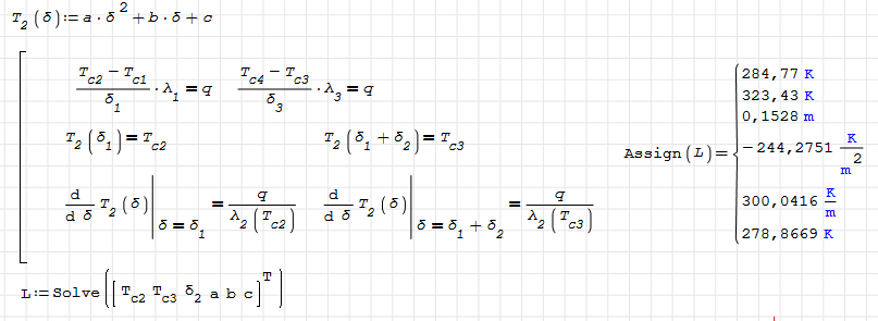

#4 Posted: 7/15/2023 7:17:49 AM
1,361 likes in 2,275 posts.
Don't know if that is the simplest solution.
Stenka-3-eng.sm (58.13 KiB) downloaded 1396 time(s).

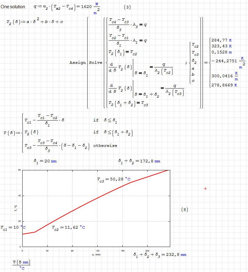

#6 Posted: 7/15/2023 7:32:04 AM
Version with mathcad block to collect the equations
Stenka-3-eng1.sm (59.5 KiB) downloaded 1415 time(s).
Valery Ochkov 7/15/2023 7:40:00 AM

#8 Posted: 7/16/2023 5:40:21 AM
Valery Ochkov
Valery Ochkov
Stenka-3-eng.sm (60.64 KiB) downloaded 1396 time(s).
One solution from Alan Stevens
Stenka-3-Alan.sm (60.35 KiB) downloaded 1372 time(s).
