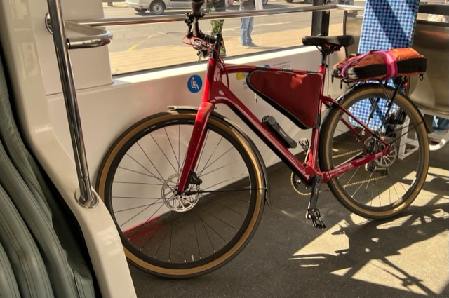

I would like to create one digital twice of my bike in SMath.
With seven instead of three gears and with a chain tensioner.
Help me please. The first step in attach.

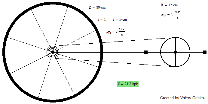

#4 Posted: 5/27/2023 2:24:29 PM
599 likes in 1,381 posts.
Your mathcad example can be done in SMath.
But I don't have the willpower to do it.
Here is the pdf for mathcad file.
And sm file without graphics.
Maybe there is a user who will help you.
bike_unleashed.pdf (61.38 KiB) downloaded 990 time(s).
bike.sm (22.83 KiB) downloaded 1622 time(s).

#5 Posted: 5/27/2023 10:00:50 PM
1,139 likes in 1,805 posts.
4+3 gears.
Click to enlarge
bike.sm (22.27 KiB) downloaded 1599 time(s).
