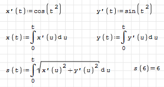

This is a clothoid or Euler spiral (https://en.wikipedia.org/wiki/Euler_spiral). It is said about it that its curvature depends linearly on its length. How to show it in SMath?
Spiral-Euler.sm (5.75 KiB) downloaded 1458 time(s).

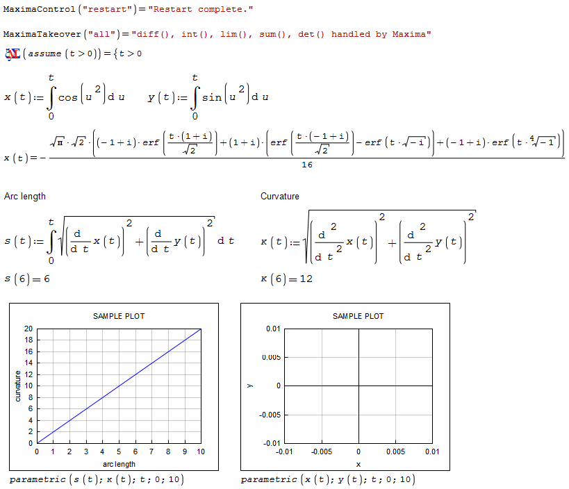

1,361 likes in 2,275 posts.
Continuing the topic
For the attached sheet to work, the Statistical Tools plugin must be deactivated, because it's erf() shadows the Maxima function erf().
The curvature-arclength plot is easily done, yet the xy plot of the curve itself fails because Maxima isn't able to evaluate the functions x(t) and y(t).
Yet, it is not proof of linearity, just an illustration.
Spiral-Euler_Kr.sm (34.32 KiB) downloaded 1453 time(s).

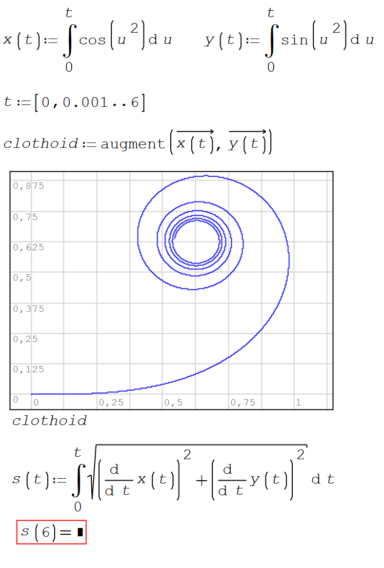

#8 Posted: 9/28/2023 11:22:42 AM
1,558 likes in 1,868 posts.
Click to enlarge
Valery Ochkov 9/28/2023 1:07:00 PM, Oscar Campo 9/28/2023 1:26:00 PM
