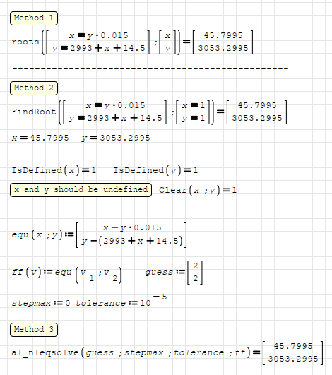

Here is your equation solved in various ways.
solvers.sm (10.77 KiB) downloaded 1283 time(s).

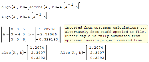

how to get the result of x, y without using the matrix ?
Matrix style is more commonly encountered in Engineering projects.
That add-on will enrich your future projects.

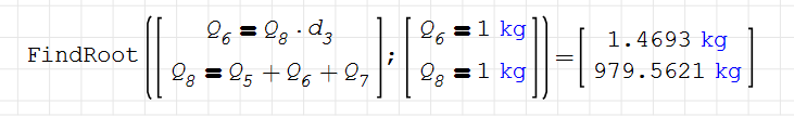

Excellent reply!
FindRoot is better for my condition, I need units.

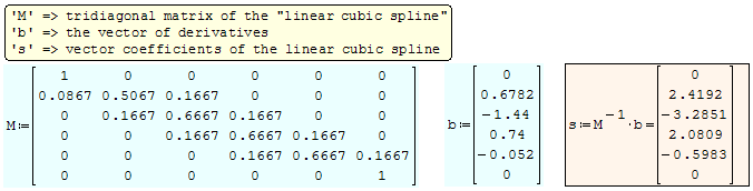

#6 Posted: 1/1/2022 3:38:12 PM
That example has only one CAS route ... naturally 15 D.
