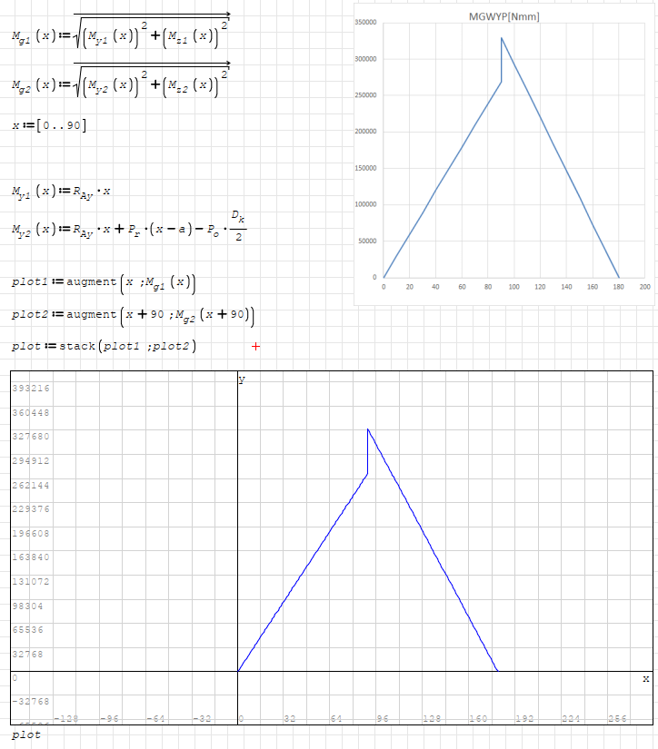

I was stuck in a ragged moment. I don't know how to draw a graph. Finally, a correct chart made in Excel.

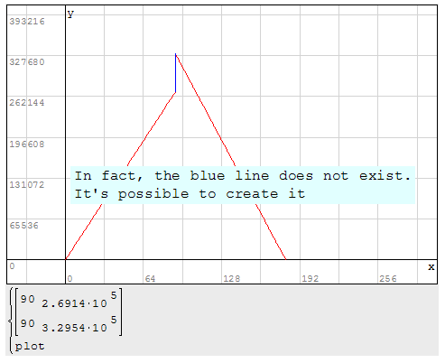

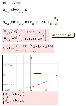

I have problems with ]the Mg1 (x) and Mg2 (x) graph, this one at the end.
proba do wyslania.sm (50.09 KiB) downloaded 1324 time(s).
#4 Posted: 9/9/2022 2:07:58 PM
All graphs plotted ...
proba do wyslania.sm (55.25 KiB) downloaded 1288 time(s).

If I understood correctly, you are trying to plot graph picture in your file.
Here it is, you can download and check it from file below.
proba do wyslania.sm (46.79 KiB) downloaded 1293 time(s).

... for convenience: cumulative integration added.
proba do wyslania (1).sm (59.29 KiB) downloaded 1291 time(s).

Actually you don't need stack, augment, vectorize, etc.
It can also be plotted easily like this.
proba do wyslania.sm (45.61 KiB) downloaded 1297 time(s).
