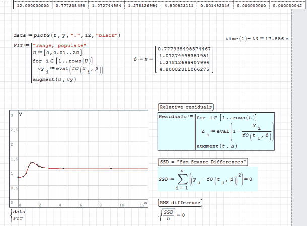

For this particular example, Carlos algorithm spits out in < hart beat !
Thanks again Carlos, it will surely help revamp some/many of the GenfitMinimize.

#3 Posted: 9/20/2018 11:23:37 AM
WroteHello Jean,
The same example of the Levenberg Marquardt Algorithm, but obtaining
the Jacobian Matrix through finite differences
Thanks, Carlos: works fine.
More doctoring for you !
The work sheet "Otherwise" is only slightly otherwise for convenience, works fine.
The "Jacobian Fails" is another model attempted, Jacobian complains ... Ah !
Same model Pharmacokinetics works fine Conjugate gradient Minimize.
True: some model function can only be fitted by hand
True: GenfitMinimze may be difficult to initialize but work fine for my huge
collection [about 80 projects in Smath].

#4 Posted: 9/20/2018 12:04:20 PM
WroteMore doctoring for you !
Jacobian is rescued but does not finish solving
... God does not love Jacob anymore !
Levenberg_Marquardt_Code_CBG Model Otherwise Jacobian NOT calc.sm (39.62 KiB) downloaded 1289 time(s).

#6 Posted: 9/21/2018 4:50:22 PM
WroteHello Jean
Here is the L-M file that works with your example.
Thanks Carlos for doctoring.
By some regrouping, timing dropped from 3.8 min down to 2.6 min.
Niece Smath document for classroom and publishing.
Genfit Pharmacokinetics L-M Copy.sm (60.57 KiB) downloaded 1204 time(s).

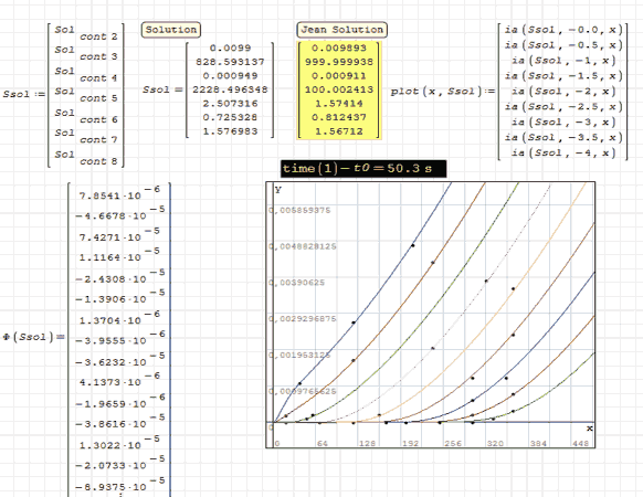

#7 Posted: 9/26/2018 6:03:04 PM
Hi Jean
Another example of the application of the Levenberg Marquardt algorithm,
this time with the Tesla function.
Levenberg_Marquard_Tesla_OK_CBG.sm (546.62 KiB) downloaded 1329 time(s).
