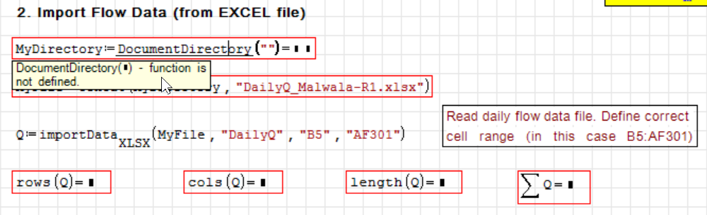

However, I get an error "DocumentDirectory(.) - function not defined", when trying to import an EXCEL data file.
Several attempts with clean reintallations did not work.
The SS file and Excel data file are attached.
DailyQ_Malwala-R1.xlsx (84.85 KiB) downloaded 817 time(s).
Test.sm (94.18 KiB) downloaded 1131 time(s).
#2 Posted: 7/22/2016 5:19:06 AM
2,343 likes in 4,042 posts.
Confirmed. My fault. Will fix later today.

#4 Posted: 7/22/2016 3:02:07 PM
Fixed. New beta version released.
