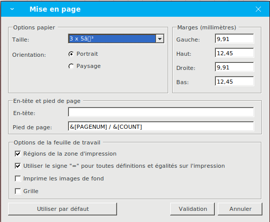

context: smathstudio 99.xxx, ubuntu 20.04 64bits, Mono JIT compiler version 6.12.0.122
I have noticed some little anomalies on linux:
- fonts displayed on combo menu (see 1.png joined)
- layout-printer, when i select and validate A4 format by default, a strange format
is displayed (see 2.png joined).
Thanks a lot
Philippe DALET

I have found the origin of these anomalies.
In the folder /usr/share/fonts/truetype/
the fonts below does not work.
droid kacst-one lohit-gujarati lohit-tamil RaghuMalayalamSans-Regular.ttf
fonts-guru-extra libreoffice lohit-kannada lohit-tamil-classical samyak
fonts-kalapi lohit-assamese lohit-malayalam lohit-telugu samyak-fonts
Gubbi lohit-bengali lohit-oriya Navilu
kacst lohit-devanagari lohit-punjabi openoffice
for the layout, the page 3 x5à comes from my printer (brother).
