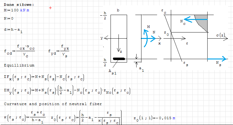

In my previous topic I was struggling with getting properly built equations.
Right now, I have prepared document, where I am looking for two unknows, basing on set of two equations. Can anyone take a look and help me to solve it? (attachment)
BR.
Strain_stress - SMath forum.sm (31.74 KiB) downloaded 1430 time(s).

Could you explain me what have you done in that "check" and what was you looking at?
I attach general rules of the method. Maybe I have some mistake hidden in equations? Solution should exist.
Strain_stress - SMath forum.pdf (522.3 KiB) downloaded 795 time(s).

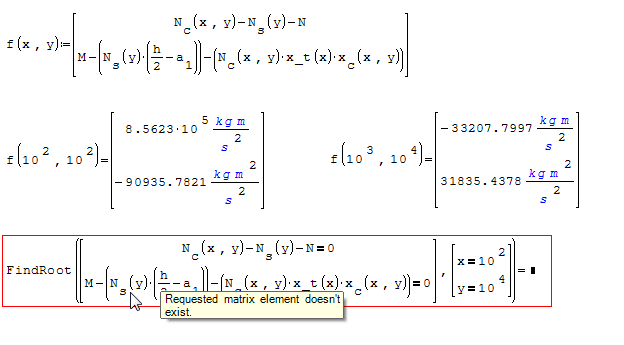

Wrote...and want to solved them in a strictly numerical fashion ie. find the roots of the system, or to use some optimization procedure...you are doomed
How can I solve that otherwise? Is there any different way to get results (more or less accurate)?
Does different, similar software solve that? (f.e. Mathcad)

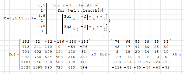

I tried to setup the procedure in an slightly alternative way and tried several ways to represent the stress-strain curves (cases, linterp, abs)
There may be errors in the equations, but this is just how far I got, just to understand the mechanical problem.
The equations fail to be solved using roots(). Also Davides functions can't handle the integration variable, which unfortunately is blamed to be unknown.
I guess, an option would be to provide analytical expressions for the stress resultant and it's centroid. For trapezoidal shapes that should be pretty easy.
Reinforced-beam.sm (311.79 KiB) downloaded 1343 time(s).

At this moment I want to solve equation, where I have given design moment (M) and axial force (N). The results I want to get are strains in both concrete and steel.
You are right that I am not calculating resisting moment right now.
The next step will be to get all possible moments (M) and forces (N), where strains are given to prepare so called interaction diagram N/M. Result below.
The formulea is true only when Eps.1>=Eps.yd=fyd/Es and Eps.2>=Eps.yd=fyd/Es - we can use M.Rd (6.30).
Otherwise then in equation we have to use correct value of stress σs=Eps*E.s and σc - then we may use the same formulea (6.30), but instead of fcd and fyd we will have fcd(eps.c) and fyd(eps.s).
I don't know if it is clear for you, if not please do not hesitate to ask.
I am still looking for solution of that problem.

Conventional approaches for the formation of the interaction diagram provide for the allocation of the state strain from which are deduced the pairs of M-N values using the equations of equilibrium. By repeating the procedure for a predetermined number of states deformation (significant and well-known) is obtained the diagram. Your approach seems also inadvisable from a numerical point of view as it would require the solution of the problem not linerare for a number of times not be defined a priori. About that last remark someone with more solid theoretical basis of my might prove me wrong.

WroteAlso Davides functions can't handle the integration variable, which unfortunately is blamed to be unknown.
Quite right Martin,
Mathcad 11 would not solve either because the integral is not a continuous
analytical function. Easy to cope via discretising the integral.
Finite differences is exceptionally valid for the remaining of the project.
There may be an alternate route via the "incremental companion". Not tried
because eventually the project must end to an export data table solution.
This project resources to many Smath great maths.
