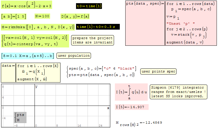

Integrate with ode solver.sm (29.07 KiB) downloaded 1180 time(s).

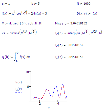

You may not be able to implement the Mathcad bloc Given/ODEsolve.
ODEsolve is based on linterp. That is the first point.
The other point is that in Mathcad "linterp(x)" is a scalar function.
In Smath: ainterp, cinterp, linterp are simply interpolation fncts
They are not scalar functions. How does it reflects in ODEsolve ?
In Smath, ln(x), exp(x), ... are scalar from source code.
I tried to make cinterp scalar like in Mathcad, not to avail.
Please, persist on such a beautiful idea.

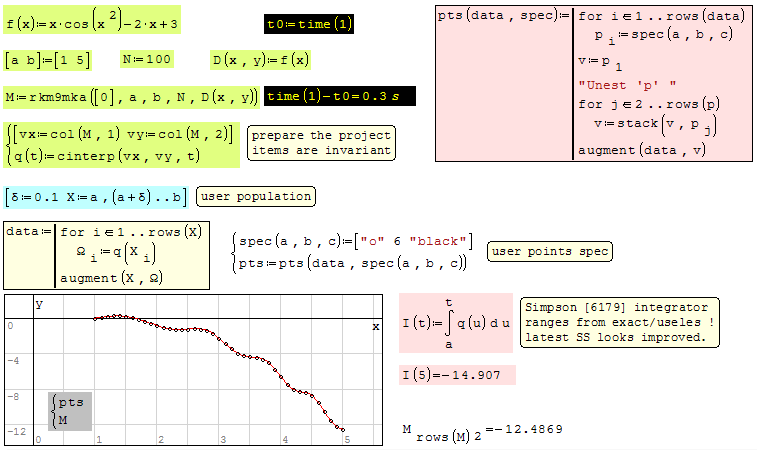

Spline Deriv Infinitesimal.sm (70.87 KiB) downloaded 1191 time(s).

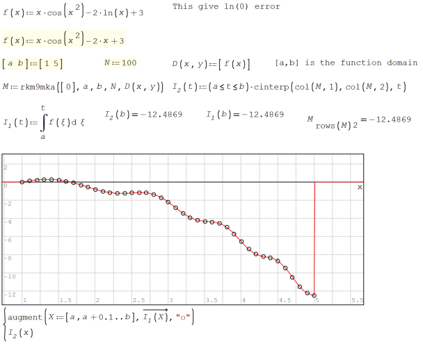

Hi Jean. Actually not, just the solver, without the given.
I found how to call the odesolver, with D(x,y)=[f(x)].
This method is much more faster than the direct integration.
But remains the ln(0) error, which seems to be a bug in the odesolvers, because zero isn't in the domain range.
Integrate with ode solver.sm (10.17 KiB) downloaded 1114 time(s).

The zero point is used to determine the dimension of the vector D(t,x) at runtime (D(0, x0)). The size of the system must be determined for the further operation of the numerical algorithm. It seems that it would be correct to substitute the beginning of the interval. I will try to change this. Also, if possible, I will support the one-dimensional case.

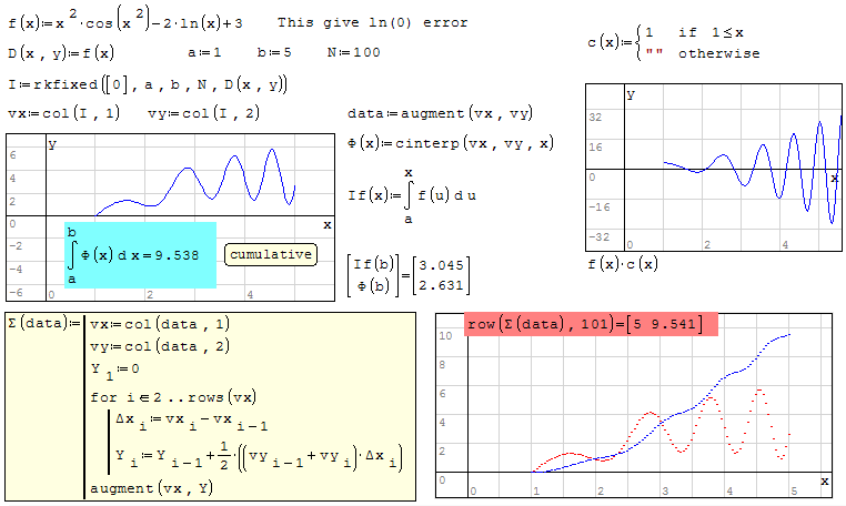

Buenos dias Alvaro !
ln(0) was introduced in Mathcad 11 soon after release via update [from recollection]
There is more in the attached, specially wrt parametric D(,,,).
ODE 0_Model General.sm (29.47 KiB) downloaded 1161 time(s).
