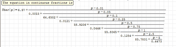

This example is an automation of the Thiele function
published by Jean in the "Utilities Pts logpts Application" sheet

#2 Posted: 5/1/2018 7:33:59 PM
WroteThis example is an automation of the Thiele function
... refreshed a bit, a note added.
Superb, the piece of automated interpolation.
Thanks Carlos ... Jean

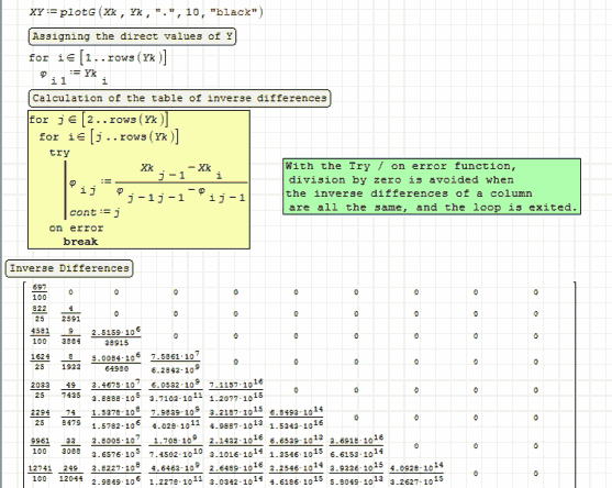

#5 Posted: 5/9/2018 6:39:36 PM
Hello Jean
Updated version of Interpolation using the Thiele algorithm in cuntinuous fractions.
It includes the calculation of the inverse differences φ [x0, ..., xi], obtained from the values in the known points
Rounding the values of the inverse differences for the purpose of presenting the equation to make it shorter
Thiele_Automatic_Jean_CBG_R1.sm (69.59 KiB) downloaded 1191 time(s).
