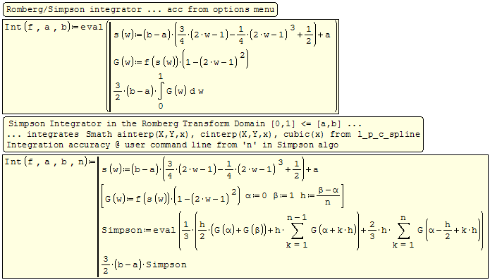

#7 Posted: 8/14/2019 10:19:49 AM
May I assume that the SMath-integral is made using Simpson's rule and that the integral accuracy [max 10000] is the number of steps taken by Simpson?
H
H
#8 Posted: 8/14/2019 11:14:29 AM
WroteMay I assume that the SMath-integral is made using Simpson's rule and that the integral accuracy [max 10000] is the number of steps taken by Simpson?
Quite right: The Smath integrator is Simpson.
Ranged accuracy [50 ... 10000]. Trivial cases are exact.
Two more exact cases are know 1/x [ln(x), b_spline].
On long range of the variate 'x' the Simpson/Romberg kernel
gives a much better result than simple Simpson.
Carlos adaptive algorithm is fool proof all cases.
You want these two proposed ... reply YES/NO.
#10 Posted: 8/14/2019 7:07:51 PM
As you can see, Romberg has the virtue of reducing the range of integration
in the [0 ... 1 ] domain. In two versions directly associated with the
Smath native Simpson integrator or Simpson algo style, thus integration
accuracy 'n' @ the user command line.
These two documents are like minimalist tool box.
Integrate Compendium_1 Romberg_FD_Adaptive [Carlos].sm (142.88 KiB) downloaded 934 time(s).
Integrate Compendium_21 Simpson-Romberg Merit.sm (138.06 KiB) downloaded 1037 time(s).
