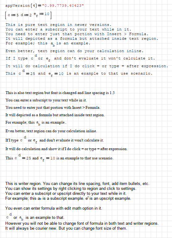

Maybe usage of text region as it is shown in example below can satisfy your needs.
If you install Writer Region plugin you will find out it has more capabilities.
subscript.sm (10.29 KiB) downloaded 1289 time(s).
