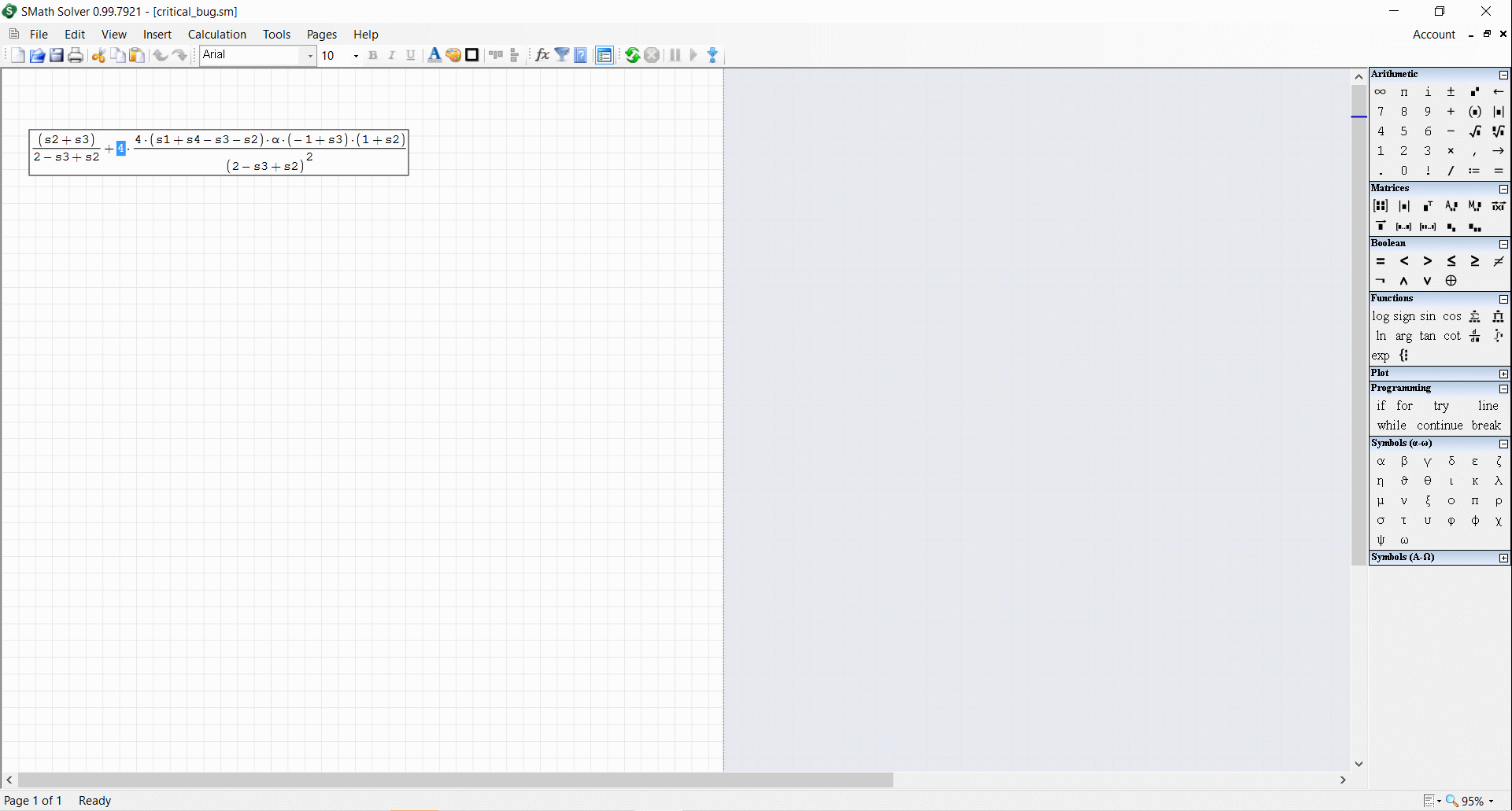

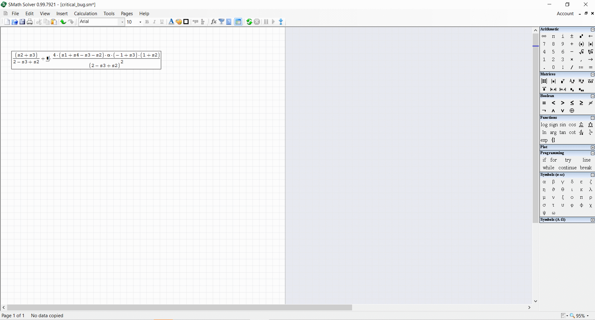

Try to delete the first number "4" in front of the ratio.
Step 1: Select it with the cursor.
Show Spoiler
Step 2: Press "Del", the "4" turns into a black square.
Show Spoiler

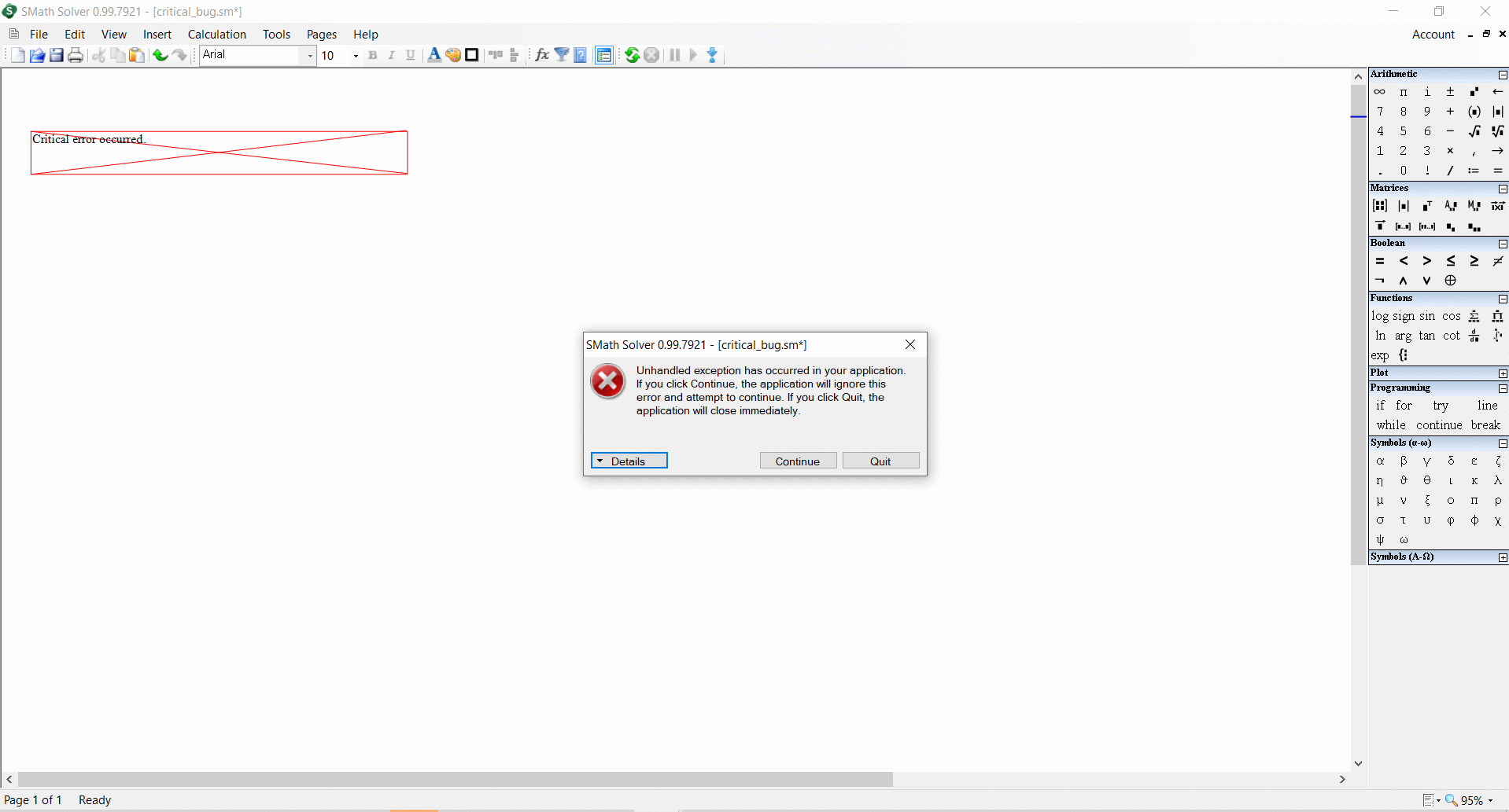

Step 3: Press "Del" once again. SM pops on "Critical error".

I can also confirm the existence of this issue ( "v0.99.7921.69" ). Upon investigation, I have (2) items:
  1) The program does not actually 'crash', the program is still running. Thus: you can recover from this bug without losing all your work!
      a) To recover from this error:
            1) On the " Unhandled exception has occurred ... Index was outside the bounds of the array" popup error message, Click on the button: 「Continue」
            2) 'UNDO' your last action, either via the menu bar: 「Edit」 -> 「 Undo」 or via keypress 「Ctrl」 + 「Z」
            3) Repeat steps #1 and #2 until you achieve a successful 'undo'.
  2) The elements of this error seem to require a grouping operator (e.g., Absolute Value, Parenthesis, Determinant, Square Root, Matrix) that is paired with a fraction/division operation, prepend this with a multiplication statement and you can duplicate the error. See screen capture below:

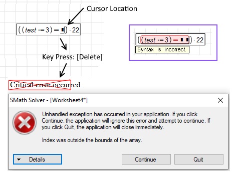

#14 Posted: 6/23/2022 11:31:02 AM
⚜ Kenny Lemens, P.E. ᵂᴵ
85 likes in 179 posts.
Greetings,
I found another configuration that can trigger this error; if you declare/evaluate a variable, and then try to multiply that entire set: you get a syntax error. Now if you attempt to correct the statement by using the [DEL] to remove the evaluation, the error gets thrown (as shown below):
The work around would be to use the [Backspace] to delete/correct the equation, or to copy/paste the terms into a new statement without syntax errors.
