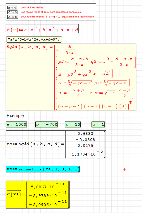

#3 Posted: 3/18/2024 7:32:28 PM
ioan92
ioan92
180 likes in 120 posts.
Hi JJ,
Here is a solution:
Ioan

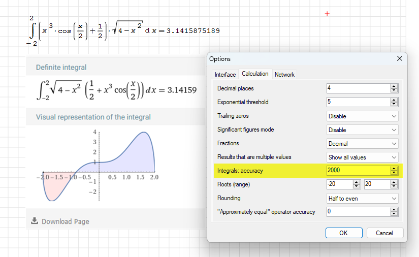

int((x^3*cos(x/2)+1/2)*sqrt(4-x^2),x,-2,2) is calculating incorrect
#6 Posted: 4/2/2024 3:48:37 PM
1,443 likes in 2,935 posts.
You have to play with the "Integrals accuracy" global setting (Tools > Options... > Calculation)
