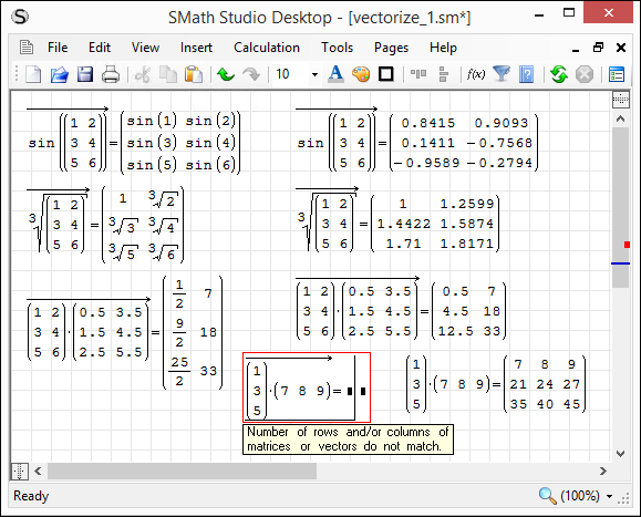

#8 Posted: 3/4/2016 2:35:35 PM
2,343 likes in 4,055 posts.
FYI, I'm currently working on this feature.
Regards.

#10 Posted: 3/5/2016 6:59:22 PM
Regarding initial question: see vectorize(..) function into new nightly build release: http://en.smath.info/forum/yaf_postst7329_SMath-Studio-0-98-5908--05-March-2016.aspx
Regards.
