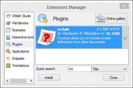

In the "extensions" section you can see the plugins "includes" and "run". They are very useful to extend and interact with other sheets. Other plugins interact with the outside.

Thanks seems that what I looking for create hierarchy between different pages - so one page can include basic model and user define functions that I will use in different works
But I don't know where to find the "Extension" section you talk about - didn't find it in the list of plugins may be I miss somting

#6 Posted: 7/2/2016 4:59:10 PM
2,343 likes in 4,055 posts.
I found the plugin copy the DLL to smath plugin dir but when run smath get error: The following plugin cannot be start GUID.... Access to path c:\Program Files (x86)\SMath Stdio\plugins\log.txt is denied
Please, never put/edit/remove any files from c:\Program Files (x86)\SMath Stdio\.
Use Tools > Plugins from SMath Studio main menu, switch to Online gallery and install plug-in:
P.S.: Do not forget to revert changes from c:\Program Files (x86)\SMath Stdio\plugins\.
