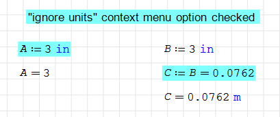

This works only on on direct definitions.
e.g. A:3'in [with ignore units on A definition] will be stored as 3 (dimensionless), but B:3'in and then C:B [with ignore units on C definition] won't work.
The latter would not help RFreund even if it worked, as data is stored in base units, as mentioned by Martin.
![2024-01-23 14_20_12-SMath Solver - [Worksheet1_].png](/en-US/files/Download/eXcGuF/2024-01-23-14_20_12-SMath-Solver---[Worksheet1_].png)
