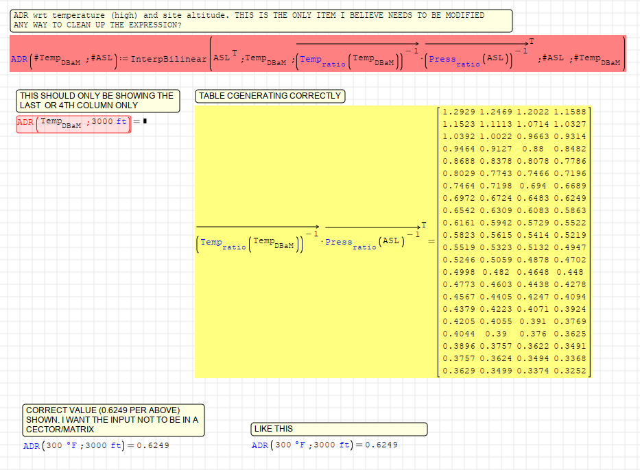

Some direction would be appreciated. This is a function I created and I got it to work straight up; however, I am trying to eventually generate the table (visual cue) and "cherry-pick" the value used in calculations. The values are coming into the matrix, but I'm stuck being required to input the argument as a vector/matrix.ADR.sm (127.5 KiB) downloaded 1191 time(s).

Quick brute force for a range of values, AFAIU.

... here is a more complete search.

Aaah now I get what you meant.
This should solve your problem.

Is this using the Maxima Plugin? Yes, this is what I was looking to do. I started playing with the Maxima "Solve" feature giving me indigestion. Thank you
InterpBilinear() is in the 'Custom Functions' plugin.
Basically an interpolation with two variable.
Good and useful function.

... from the attached example,
get inspired to construct the data ready for matrix interpolation.
