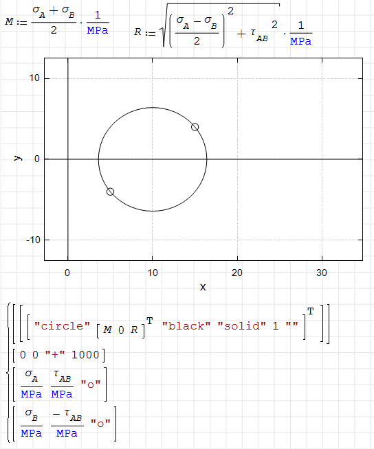

I am trying to plot mohr's circle by following tutorial. I have succeeded to draw circle on the tutorial but not mine.
Could you check my plot?

One way to build a graph is to lower the order of large numbers
Primer.sm (8.51 KiB) downloaded 1220 time(s).

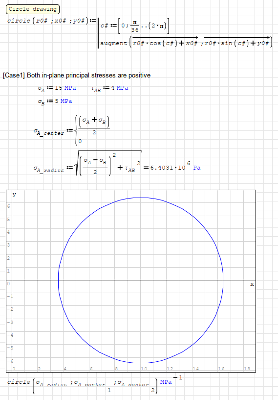

You can make a function to draw circles, for multiple usage on same sheet.
With respect to Ber7, dividing it to MPa will lower the numbers too.
MSS.sm (7.3 KiB) downloaded 1261 time(s).

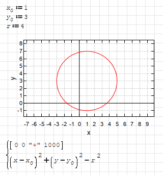

Here is a version with pre-defined geometric object in the XY plot plugin. See Handbuch section 8.3.4.
MSS_Kr.sm (13.86 KiB) downloaded 1255 time(s).
Circle de Mohr.sm (47.02 KiB) downloaded 1261 time(s).
