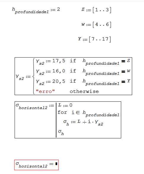

#1 Posted: 1/5/2022 6:03:42 PM
Good afternoon, could someone explain to me how to solve this problem I need that the horizontal voltage varies according to the depth however and the s2 gamma.
my input data is hprofundidade1 z w and y
TESTE TENSAO ADM MATRIZ.sm (5.41 KiB) downloaded 1215 time(s).

#3 Posted: 1/6/2022 7:57:04 AM
WroteWroteGood afternoon, could someone explain to me how to solve this problem I need that the horizontal voltage varies according to the depth however and the s2 gamma.
I don't understand the problem, only to get a plot.
Good morning,
I reworded the file with an SPT matrix, my goal is to loop to find the value of sigma h in the depth that I inform in the input I am attaching a photo of what the final result should look like with the graph
TESTE TENSAO ADM MATRIZ.sm (13.15 KiB) downloaded 1231 time(s).

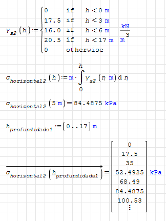

#4 Posted: 1/6/2022 3:04:40 PM
Hi. I think that this could be the solution.
TESTE TENSAO ADM MATRIZ.sm (5.88 KiB) downloaded 1227 time(s).
#5 Posted: 1/6/2022 4:49:36 PM
WroteHi. I think that this could be the solution.
I still don't understand purpose of for() loops. (not in your solution, original question)
Removing for()'s and calculating directly won't change the result.
#6 Posted: 1/6/2022 7:06:33 PM
WroteWroteHi. I think that this could be the solution.
Hi overlord. I guess because using γ.s2(h)*h isn't correct, there the correct acumulation is γ.s2(h)*Δh
TESTE TENSAO ADM MATRIZ.sm (10.8 KiB) downloaded 1197 time(s).

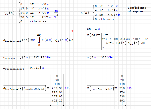

#7 Posted: 1/7/2022 8:51:39 AM
#8 Posted: 1/7/2022 11:23:15 AM
WroteWrotethank you all for making your time available, helping me with this problem but some of the solutions posted here do not match the values must be equal to sigma,v in the image or 70 kN/m2 at 4m depth and 118 kN/m2 at 7m depth.
At this point, up to You to handle the project.
I understood nothing in that big image.
TESTE TENSAO ADM MATRIZ (in_situ parametric).sm (18.6 KiB) downloaded 1270 time(s).
PERFECT FELL LIKE A GLOVE is there a way to rotate the result of the graph 90 degrees?
#9 Posted: 1/7/2022 4:01:35 PM
#10 Posted: 1/7/2022 5:44:30 PM
This is a way to do that in SMath.
TESTE TENSAO ADM MATRIZ v2.sm (455.7 KiB) downloaded 1334 time(s).

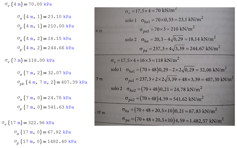

#13 Posted: 1/8/2022 4:45:12 PM
Wrote(don't download this)
Offered as demanded in two separate parts in same document.
Thank you all for making your time available, helping me with this problem but some of the solutions posted here do not match the values must be equal to sigma,v in the image or 70 kN/m2 at 4m depth and 118 kN/m2 at 7m depth.
see the resolution of the problem in the attached image
Project Algo_Parameters Copy.sm (663.42 KiB) downloaded 1245 time(s).
