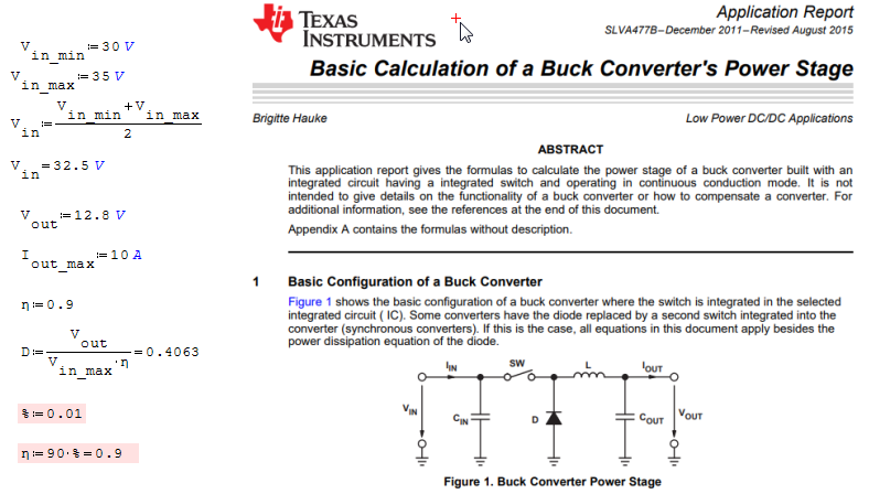

The attached sMath file is an attempt to add "current page" background images. One image per page. It work find for the first two pages, but the third one get skipped and the image appeared on the fourth page.
dc dc buck converter.sm (735.13 KiB) downloaded 1270 time(s).
Basic Calculation of a Buck Converter Power Stage.pdf (202.96 KiB) downloaded 931 time(s).
The goal here is to study technical document by overlaying sMath formula, graph and other elements on top of the background images.
Also attached, the original PDF file and the png images for each pages.

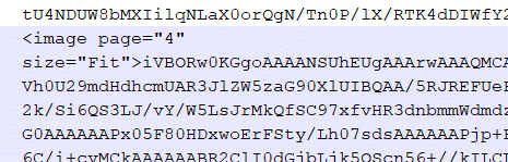

I did not know that several background images can be inserted. Actually, I do not know how to do it either. But as workaround you can edit the sm file for correct the position of the image on page 3.
dc dc buck converter.sm (735.13 KiB) downloaded 1249 time(s).

Editing the file worked first try. That is great :-) The sm format is pretty simple, nice to see that.

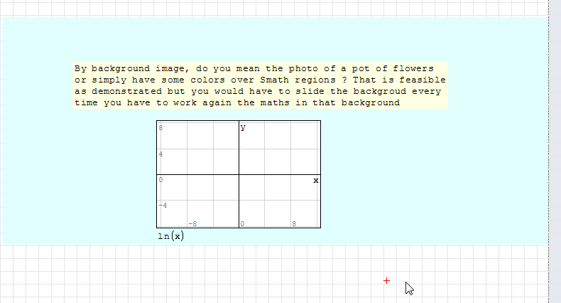

This peanut demo is 2.65 kB. You can have as many regions as you wish,
of any colors out of 1677216 possible colors. The background is OK
by the Print Preview, thus will be saved on virtual *.PDF printer.
This background region is not an imported image, neither an image
created by Smath. Thus, every time you save and at the opening of
the document, Smath complains it can find ... because it is not
really created ... just an incomplete fake. So, on the complain
just click OK to stop Smath suffering.
Jean [Drummondville]

All like this:
1. 2 months ago, I open your *.sm ... all pieces of Smath scattered in ~ 10 pages.
All anywhere in the page ... though nothing to do.
2. Today: open again, realign/space like normal ... toke ~ 15 min
3. Then guess what ,,,
4. Suddenly, Texas stuff appeared dead like stone,
good thing a bit off right of Smath formulas.

Fresh example of use to annotate with image region (this is neat!)
