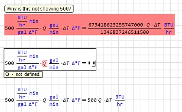

Hi. SMath convert all numbers to it rational approximation in symbolic outputs. Maybe you can use this trick: put Q*ΔT in units and use numeric evaluation:

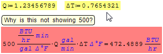

Help with the highlighted please. How do I put the variables into Units? File is updated on my laptop to numeric evaluation.

The error message reads yellow not defined

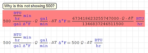

HVAC Constants.sm (62.47 KiB) downloaded 1189 time(s).
Hi. Just write them: " Q*ΔT*'BTU/'hr " in the unit's placeholder.
I attach the file too.
Got it. You force the solution (=) side to keep Q and ΔT as variables. I think I tried everything BUT that!
