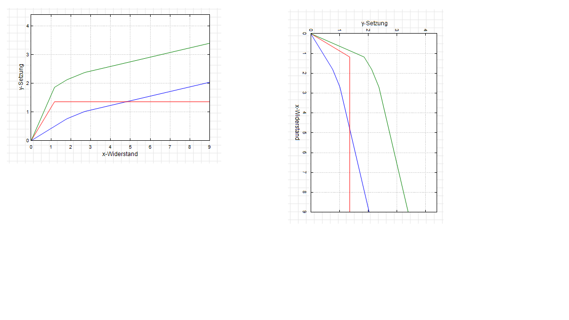

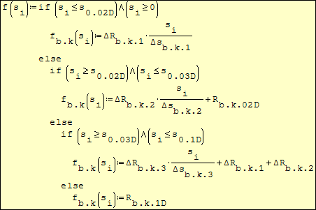

Hey guys,
im trying to plot my function with x-yplot (addon) but it doesnt work. I will be happy if can someone can help me.
i define two functions (with If-clauses) and now I have to put it in x-y-plot.
Thanks for helping
Pfahlsetzungslinie.sm (101.89 KiB) downloaded 1351 time(s).
#2 Posted: 2/11/2023 9:51:05 AM
I define two functions (with If-clauses) and now I have to put it in x-y-plot.
1. Start by the first red instance ... assign the demand.
2. For the plot Units don't match
3. Check if your incomplete Bolean is OK ... here shown complete.
4. What is mPa
#3 Posted: 2/11/2023 11:27:05 AM
599 likes in 1,381 posts.
If you want to plot, you have to eliminate units.
Either by writing a unitless function, or using units while plotting.
I would rather second one.
Pfahlsetzungslinie.sm (112.67 KiB) downloaded 1401 time(s).
Click to enlarge

i have 2 more question.
1. is it possible to rotate the graph or function? I wanna switch x and y axis
2. i wanna make the visible spectrum of x and y axis depent on a variable. like X-Axis Max=s1 and Min=s2
//sorry for my bad english

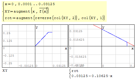

#6 Posted: 2/11/2023 4:46:06 PM
... once the discrete data set in hand,
you can rotate by any angle as desired.
#7 Posted: 2/11/2023 5:58:06 PM

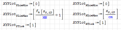

2. I wanna make the visible spectrum of x and y axis depend on a variable. like X-Axis Max=s1 and Min=s2
If I understand: once the discrete data set in hand,
very easy to range between Mi/Max.
Produce the discrete data set, I will terminate.
Cheers ... Jean.

... i have 2 more question.

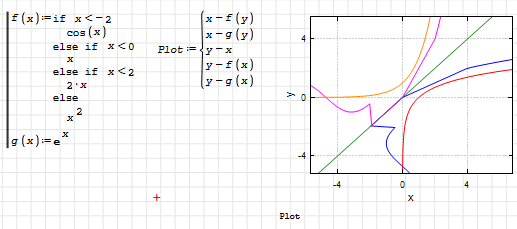

1. Yes. For example you can use this technique over your functions
xy-yx-plot.sm (7.16 KiB) downloaded 1330 time(s).
2. Yes. For example you can try to learn about how to use setprop in an XY plot region.

question 2: solved after find this
https://en.smath.com/forum/yaf_postsm57205_X-Y-Plot-Region.aspx
but to rotate the graph like this it didnt work. i tried your suggestions. Pfahlsetzungslinie1.sm (80.01 KiB) downloaded 1359 time(s).

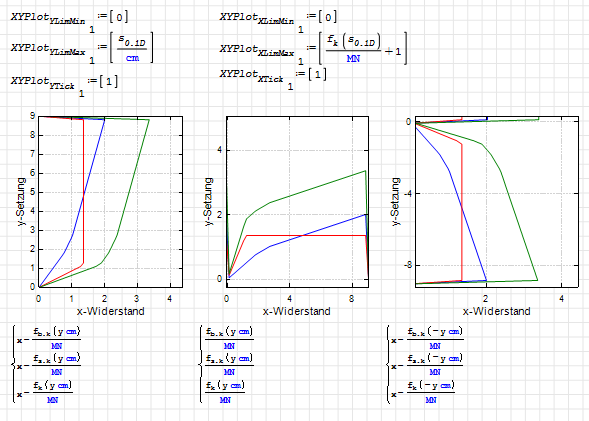

#10 Posted: 2/12/2023 8:47:18 AM
1,139 likes in 1,805 posts.
Hi. You need to specify the XYPlot index. This is how to swap axis coordinates, and reverse the y-axis. I reduce the number of points in the XYPlot to 50.
Pfahlsetzungslinie1.sm (87.42 KiB) downloaded 1365 time(s).

But to rotate the graph like this it didn't work.
I tried your suggestions.
You haven't produced the discrete data set.
Cheers ... Jean.
Wanna Rotate.sm (14.34 KiB) downloaded 1309 time(s).

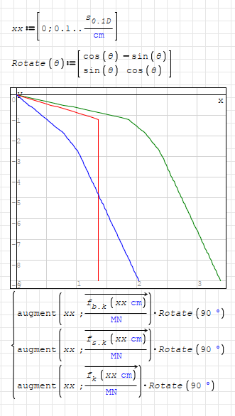

You can also use a rotation matrix.
It works on both 2DPlot an XYplot.
churichuro 2/13/2023 4:11:00 PM
#14 Posted: 2/13/2023 10:41:33 AM
Rotate XY.sm (486.01 KiB) downloaded 1357 time(s).
