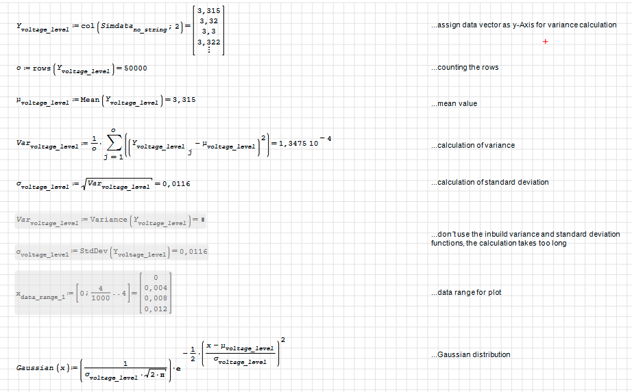

Hi SMath community,
I would like to calculate the variance() and StdDev() of the second column "V(3v3)" of the attached file with 50k datapoints. Unfortunately the calculation takes forever (aborted it after 30min).

Optimizations were all set to numeric - did not help. What helped was that I substituted the statistic function variance() and StdDev with the original/native formula for the variance and standard deviation.
This speeds it up to around 1s.
Don´t know what happens inside the functions of the statistic plugin but it is very slow.

I have noticed the same thing; the built-in function for standard deviation takes forever but the calculation runs pretty quickly if I just code in the formula in the worksheet.
#5 Posted: 4/12/2024 4:53:41 PM
Confirmed, the bottleneck seems to be in the final ouput processing to return the result from the equation [f.e. 1/{n-1}*sum(((el(X,i)-mean)^2),i,1,n)) for StdDev]; no idea not sure what could be the cause...
