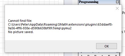

I'm getting the following error when saving a sheet
i'm using Version 1.0 (build 8151)
I've tried disabling various extensions but its still happening
Any help will be much appreciated

Hi Jean
Thanks for the reply , I tried that .... still get the error
I've also tried it on 2 different PCs with no luck

- Update SMath to latest stable (1.0.8253),
- Update all installed plugins to latest versions,
- Try to run SMath as administrator.

The error message seems related to something in the ImageEditRegion plugin
<ProjectGuid>{63DDAEF8-9A56-4FF6-938E-D590B638BF99}</ProjectGuid>

Thanks Davide,
I just disabled ImageRegion plugin and the error disappeared when i saved the sheet
Overlord - thanks for your answer
I can't upgrade to the latest stable yet as the client is using the same version as I am
