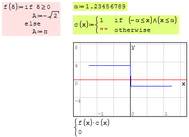

I want to do "if δ>0 then k=a+b else k=c+d"
But impossible to include the equation k:=a+b in the "if statement"
When I type "equal" after "k", the "equal" sign is put on the fist line and answer "k-not defined"
I found an exemple on the forum but I'm not able to reproduce it by myself
My test file is attached
Thank you for your help
test if statement.sm (5.23 KiB) downloaded 1149 time(s).
#2 Posted: 3/24/2019 4:47:44 PM
127 likes in 342 posts.
you have to type ":" (colon) and not "=" (equal)
