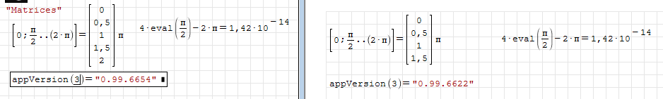

#2 Posted: 3/26/2018 5:41:04 PM
1,361 likes in 2,275 posts.
The behaviour of loops with second value seems to have improved. Is this generally fixed or just by chance?
Andrey Ivashov 3/28/2018 12:43:00 PM

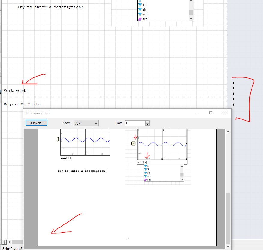

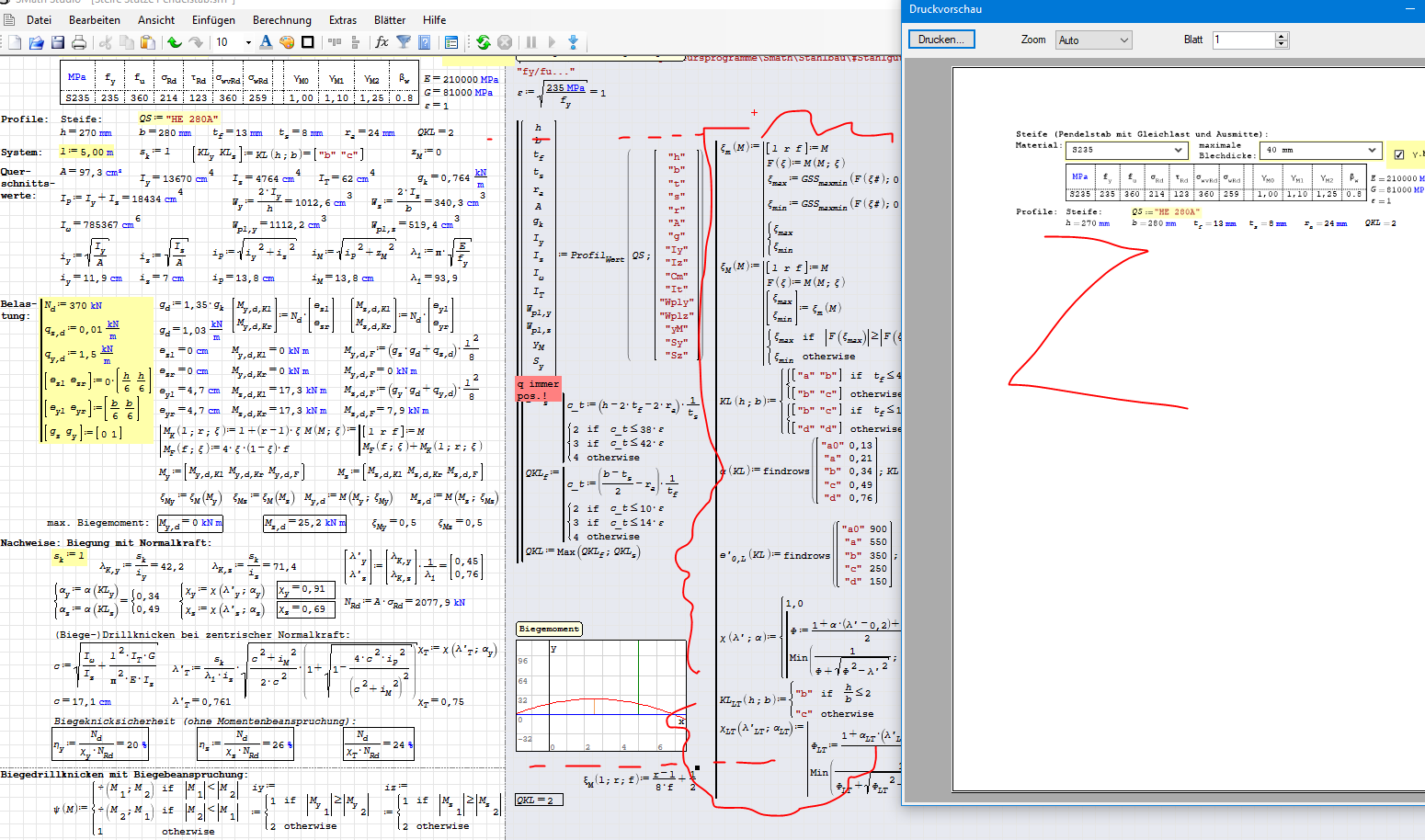

#3 Posted: 3/27/2018 3:16:09 AM
Martin_B
Martin_B
22 likes in 84 posts.
Discovered following behaviour concerning pagebrakes with very long blocks:
(scroll to right if necessary)
The red marked block is so long, that it reaches the top of following page.
As you can see in the preview window, the sheet content is not printed.
Page 2 starts after the page brake with "Biegedrillknicken" when "Printing Bounds" is used.
While using "Pages view", the first printed page looks the same (mostly white) but the second page starts with the skipped content "System l=5,00m..."
Setting the font size only of the large block to something smaller so the bottom of it doesn't reach the page brake solves this issue.

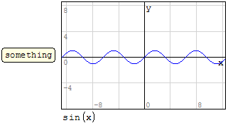

Found another issue, while editing the description of a 2D plot:
When you put the cursor in the description and edit the text, a matching variable in the input data is edited simultaneously.
Screenshot: description is edited -> a second cursor appears in input data

#8 Posted: 3/27/2018 10:39:37 AM

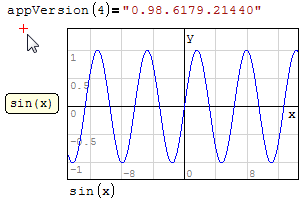

The long page brakes are not in the attachment !
sin(x0 something => no problem Smath 6179

Here you are:
We are here in the "RC2: 0.99.6654"-thread.
So I thought it would be clearly that I refer to 0.99.6654.
Take a look at the video (screen capture) if you don't believe what I am writing.

Here you are:
Sure they are (I uploaded a simplified example):

#11 Posted: 3/27/2018 3:00:06 PM
Martin_B
Martin_B
Found another issue, while editing the description of a 2D plot: ...
Your screen shot is explicit enough, but the document would help
The document is linked in post #7. And the screen capture in post #9.
#12 Posted: 3/27/2018 3:22:30 PM
Arie
Arie
94 likes in 285 posts.
Not clear w/o the document.
Discovered following behaviour concerning page brakes with very long blocks:
Maybe the problem is the construction ?
Document would surely help volunteers.
Here you are:
Pagebrake.sm (70.7 KiB) downloaded 1968 time(s).
Can repeat both bugs with the provided file on 6654. Oddly enough I was able to enter a description sometimes without effecting the data field if I first clicked within the data field, then immediately clicked the description field. This only worked occasionally and seemed dependent on where I clicked within the data field.

#16 Posted: 3/28/2018 12:42:23 PM
2,343 likes in 4,055 posts.
Here you are:
Thank you! Both issues are reproduced and will be fixed asap.

#17 Posted: 3/28/2018 12:43:47 PM
Was not my goal. Looks like some refactoring might helped.
