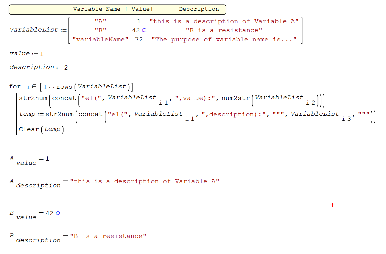

A matrix approach:
AssignValueAndDescription.sm (7.5 KiB) downloaded 1261 time(s).
Arie 10/26/2022 9:59:00 AM, Alvaro 10/26/2022 2:26:00 PM

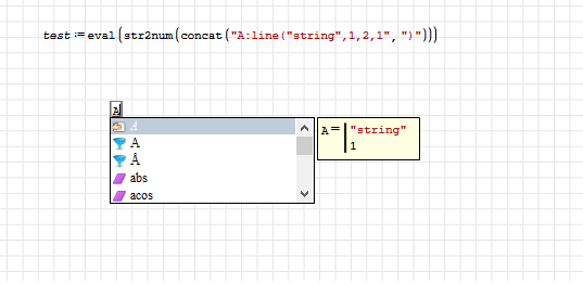

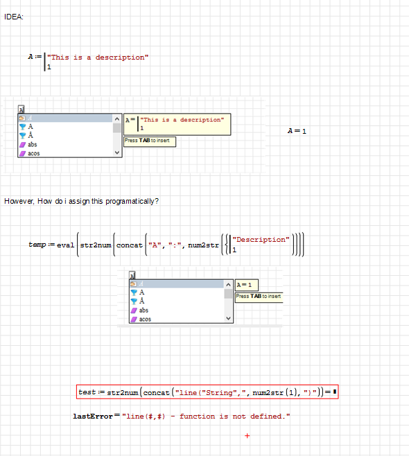

I had another idea using line function. But i'm not sure how to do it programatically... Any Ideas? Is it even possible?
Worksheet8_alternateIdea.sm (22.9 KiB) downloaded 1306 time(s).
⚜ Kenny Lemens, P.E. ᵂᴵ 10/26/2022 10:57:00 AM

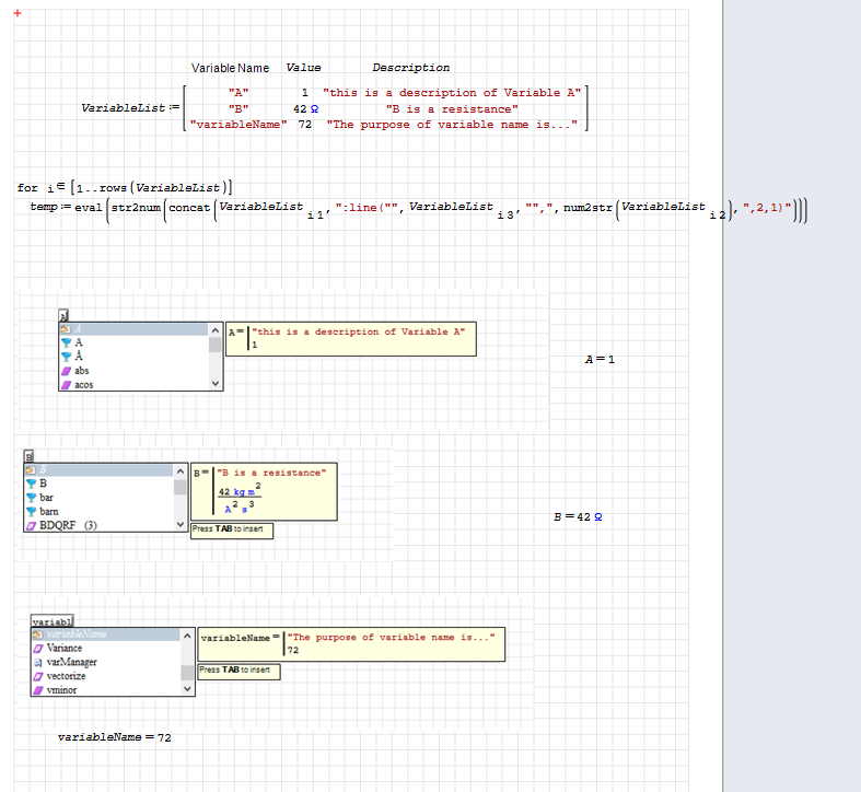

Aha! I figured it out
I'm pretty happy with this solution.
Here's my updated file for a reference:
⚜ Kenny Lemens, P.E. ᵂᴵ 10/26/2022 11:32:00 AM, Alvaro 10/26/2022 2:29:00 PM
