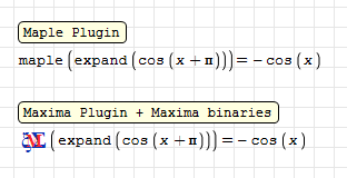

There is not an internal simplify/expand ability of Smath.
However, you can use maxima or maple plugins for this purpose.

Maple plugin can be used under linux with wineconsole + a script file + renaming + symbolic link.
Check forum page extensions > maple plugin, I have put some instructions over there.
https://en.smath.com/forum/yaf_postsm67797_Maple-Tools.aspx#post67797
Maxima plugin cannot be used under linux, yet. I couldn't make it work as it is.
I had to open my windows pc to show you expand command with maxima plugin.
