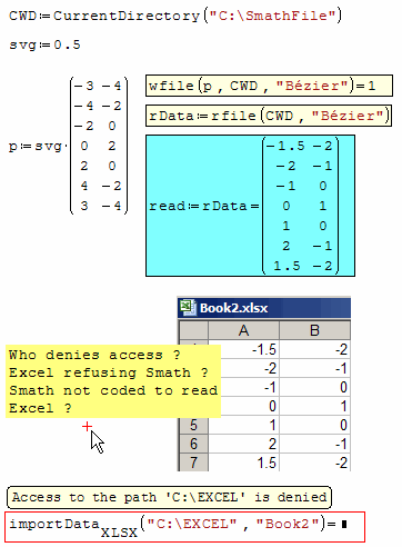

Soory kamarad, nothing works, except for yourself.
There is an unconfessed/unattended bug in reading *.xlsx

Jean,
I think the problem for your use of importDataXLSX() might be the actual inputs in there. The pop-up comment on these all say the first value should be a "path" (at least in English), but I've only got it to work by combining the path and the excel name - the filepath.
So assuming your book is in a folder called EXCEL on your C drive, and your sheet name is "Sheet1", try:
importDataXLSX("C:\EXCEL\Book2.xlsx", "Sheet1" )
However, if that "access to path.." is the true culprit, I'm unsure how to get around that aside from using a different folder path.
Davide Carpi 4/13/2016 2:08:00 PM
#25 Posted: 4/13/2016 2:10:41 PM
1,442 likes in 2,934 posts.
correct
The error you see is driven by the underlying CLosedXML plugin (I have the same using Jean's syntax in a folder on my system), I'll add a preventive check in the next update to avoid this cryptic error message.
