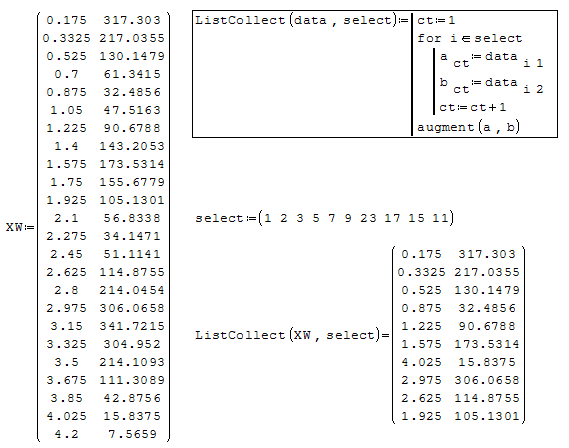

#4 Posted: 3/28/2016 5:42:27 PM
The data table can be any size, search any rows/any col.
Just modify/adapt to your project.
