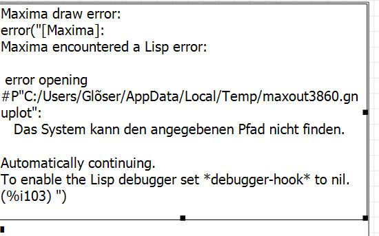

Hello SMath user,
Plotting with Maxia doesn't work. Insert /Maxima/ 2D-3D plot
results in an error message..: Cannot find the path (see appendix).
In the German language the character o with arc does not exist.
Here the path name contains the a with points ä . Can I use the
Set path Are there other possibilities? Want to use Maxima plot
not with 3DPlot.
Thank you
topsi
#2 Posted: 3/21/2019 6:08:11 PM
1,361 likes in 2,275 posts.
Normally the plugin should be unicode-proof. It uses SBCL. Does the plot work in wxmaxima?
