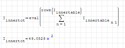

SMath Forum SMath Studio Questions Result above max allowed pos number 1 Pages (3 items) Result above max allowed pos number - Result above max allowed pos number - Messages Go to last post #1 Posted: 10/18/2013 6:40:02 PM Ryan Freund 20 likes in 339 posts. Group: User I'm I doing something wrong or am I actually above the maximum allowed positive number? Is there a way around this. To me the number doesn't seem vary large but I'm probably missing something.Here is a screen shot and file is attachedThanks,Ryan Max Positive.sm (21.11 KiB) downloaded 1281 time(s). #2 Posted: 10/18/2013 7:25:48 PM Davide Carpi 1,443 likes in 2,935 posts. Group: Moderator who knows... use eval() to avoid this issue...regards,Davide If you like my plugins please consider to support the program buying a license; for personal contributions to me: paypal.me/dcprojects #3 Posted: 10/22/2013 1:45:21 PM Ryan Freund 20 likes in 339 posts. Group: User Thank you.I would use the Thank 'button' but it doesn't seem to work with Chrome. 1 Pages (3 items) New Posts No New Posts
