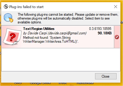

    But there is a problem with "Text Region Utilities" plugin to install.
    Davide Carpi 1/12/2017 12:17:00 PM

    The update for "Text Region Utilities" is OK now.
    Thanks again; updated both the plugins (added another small performance improvement for print preview).
