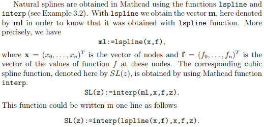

I will remind you of this document, which describes how the functions work. My implementation of interpolation has an error, but the coefficients themselves seem to be calculated correctly.
In Mathcad the first three numbers encode the type of spline. Jean doesn't know about this.
Cubic spline interpolation using Mathcad (2009).pdf (256.71 KiB) downloaded 2735 time(s).
WroteWroteIt seems that the Mathcad lspline actually it is a cubic spline.

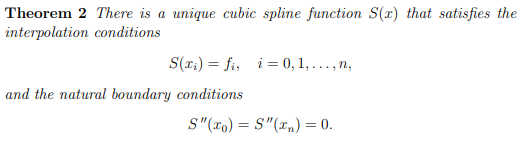

Yes, my comment is about that the lspline and pspline names could be sort of confusing, because, as the report says, mathcad's lspline, pspline and cspline are all "cubic splines". The "l" in "lspline" is not for linear interpolation, but for linear ends conditions, also called natural conditions. The "p" is for parabolic, and the "c" for cubic, all meaning ends conditions too.
Thus, Mathcad lspline is not related with SMath linterp or maple spline(X,Y,x,linear)
