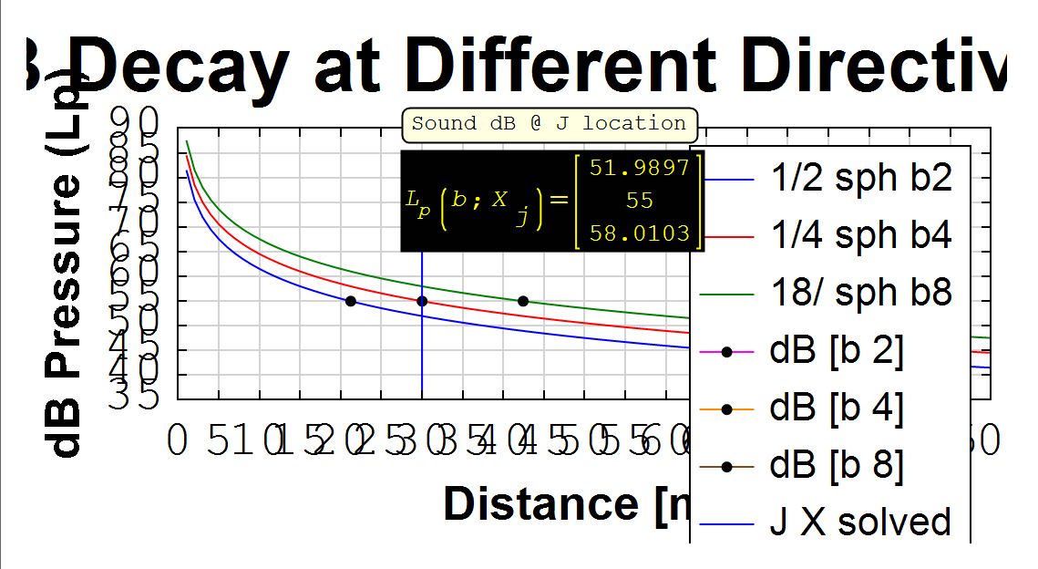

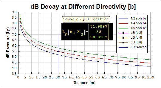

#2 Posted: 4/30/2023 6:18:45 PM
I can work with dB in Mathcad 15. How to work with dB in SMath ?
Simple example attached.
Cheers ... Jean.
Inst_dB Sound Copy.sm (142.11 KiB) downloaded 1373 time(s).

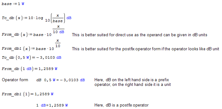

#3 Posted: 4/30/2023 7:05:14 PM
1,361 likes in 2,275 posts.
If Davide could provide operator forms for To_dB() and From_dB() then this could pretty much look like in Mathcad.
dB.sm (9.61 KiB) downloaded 1304 time(s).
#4 Posted: 5/1/2023 3:04:21 AM
Valery Ochkov
Valery Ochkov
67 likes in 713 posts.
Cheers ... Jean.
Thanks,
but how can I see your plot without any formatting?

#6 Posted: 5/1/2023 9:25:12 AM
but how can I see your plot without any formatting ?
Try to zoom your document in native Smath 100 %
#7 Posted: 5/1/2023 11:11:33 AM
That's what you should have.
#8 Posted: 5/1/2023 4:02:21 PM
Thanks,
But how can I use the postfix and prefix operators in SMath? Is there a tree operator too?
Davide Carpi has defined operator representations for some functions in his Custom Glyphs plugin. So he is the wizard who can make that happen if you convince him. He also implemented the Glyph for the Maxima().
The drawback is that users can easily read these expressions but it is hard to guess how to write these operators if you aren't aware of the background function used for it. So the best would be to have a side panel (as it is implemented for the currency units plugin).
#9 Posted: 5/1/2023 4:09:47 PM
Valery Ochkov
Valery Ochkov
Sorry, but same result.
#10 Posted: 5/1/2023 6:15:19 PM
Seems something related to DPI scaling in the plugin. Just a guess.
#11 Posted: 5/1/2023 7:20:47 PM
Originally Posted by: Jean Giraud [/url]Originally Posted by: OchkovVF [url=/forum/yaf_postsm81092_dB.aspx#post81092]but how can I see your plot without any formatting ?
Rewrite the code on your system.
