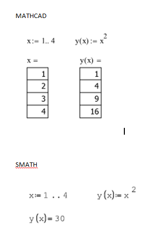

Dear SMATH users
Please help me that how to generate series or table with variable having power.
In Mathcad it is very simple
a simple calcs has been shown belwo with a variable x having power 2. In mathcad it y(x) series can be easily generated, but smath results are not same.
So guide me that how to generate similar calcs in smath.
Shafiq

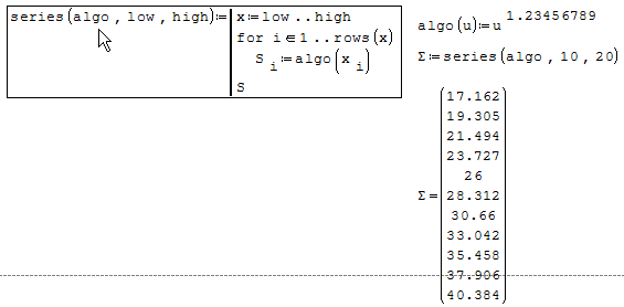

#4 Posted: 4/12/2016 5:51:22 PM
... in the attached, where you have Vectorise(f,zoom), try to write
Z:=f(zoom) under the vectorise operator and see if it works.
But don't zap the existing working Z:=Vectorise(f,zoom).
