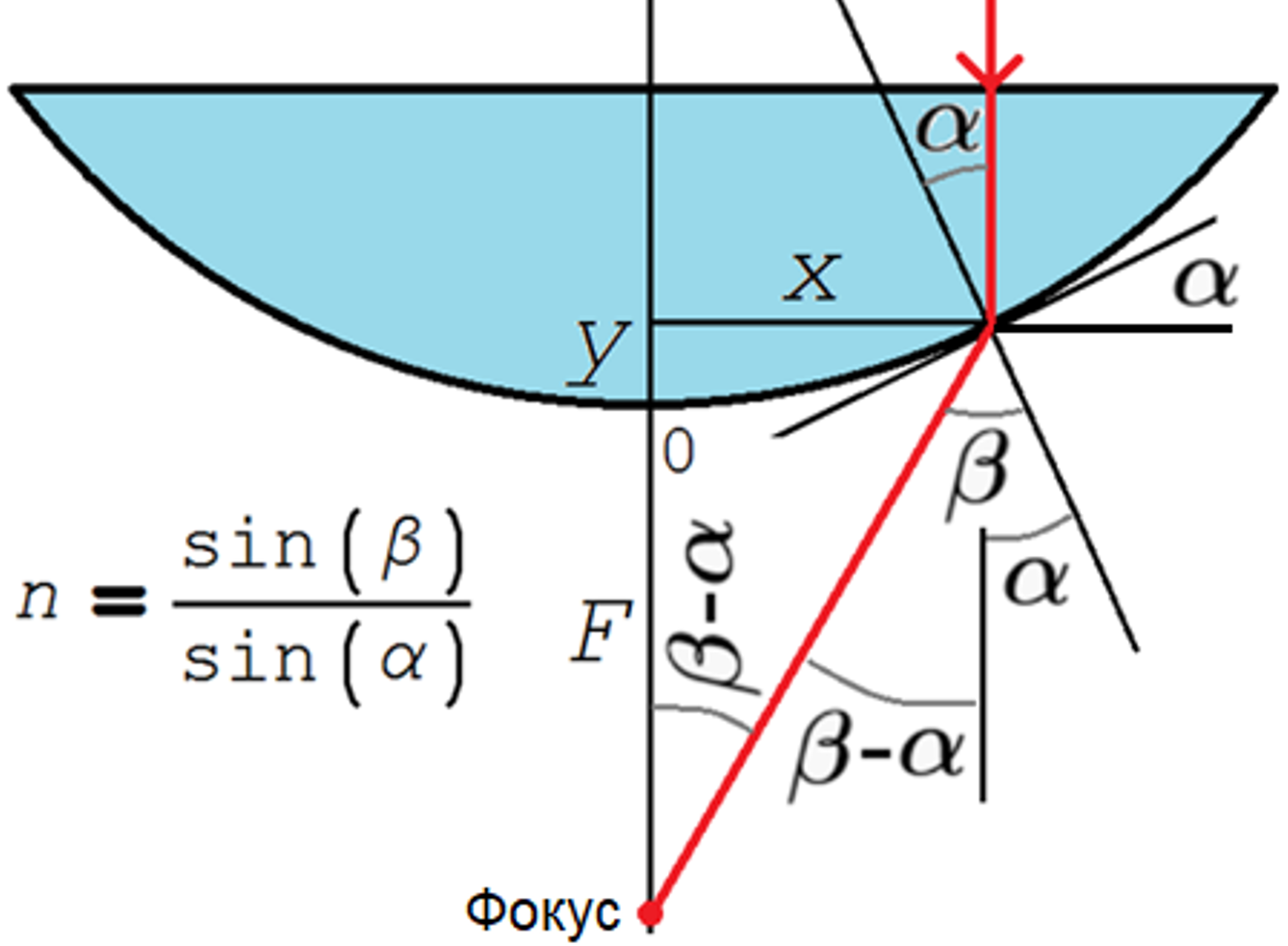

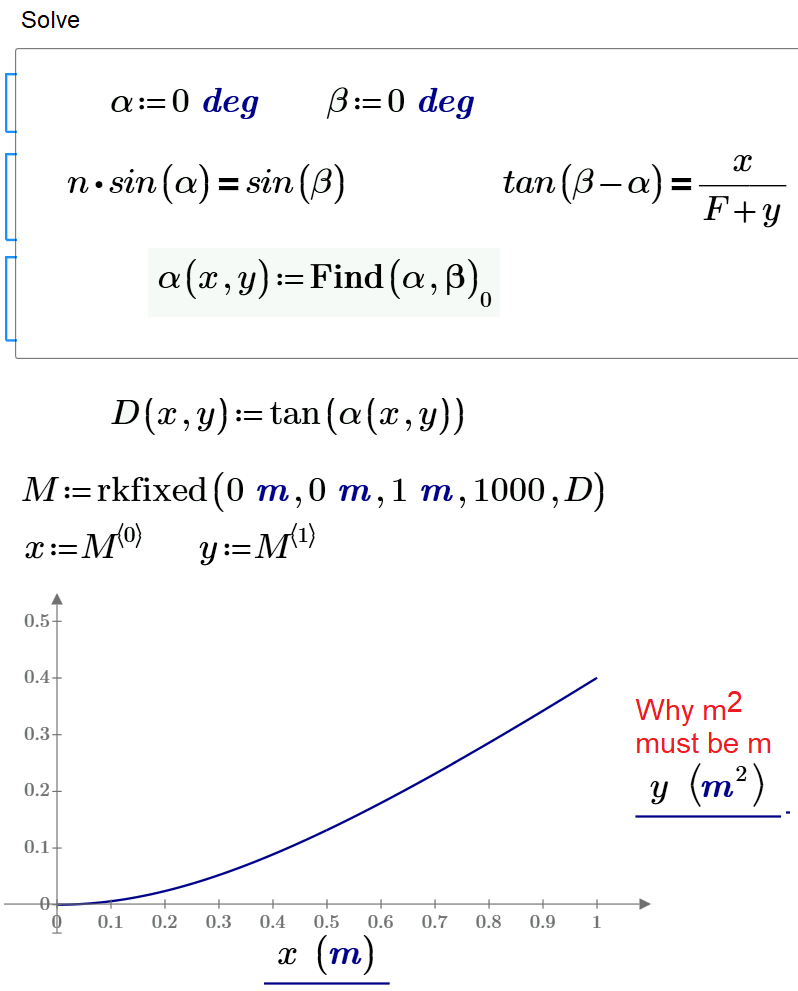

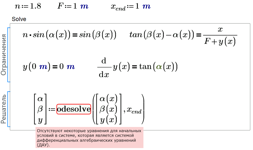

How can we use here a Mathcad-block?
Lens-Mathcad-Block.sm (43.8 KiB) downloaded 1813 time(s).
See too
https://en.smath.com/forum/yaf_postst25212_Lens.aspx
#2 Posted: 12/1/2024 6:08:12 PM
1,558 likes in 1,868 posts.
Here the function rkfixed() can't process the incoming expressions correctly. The block has nothing to do with it, it does not perform detailed analysis of expressions.
This is a bug in the function. The function has not been tested for this case. I can't see what's wrong here right now.
Valery Ochkov 12/2/2024 3:44:00 PM

This is not a solution of the rkfixed problem, just a little playing around with X-Y plot.
Here, an option of setting the aspect ratio of the axes to 1 would be good.

Question - why is the answer meters squared, and not just meters?

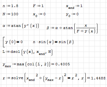

#10 Posted: 12/8/2024 8:58:47 AM
1,139 likes in 1,805 posts.
See too
Hi. dsol can solve it with this setup:
RKA-Lens.sm (179.91 KiB) downloaded 1787 time(s).
I also use the Martin's setup for the plot.

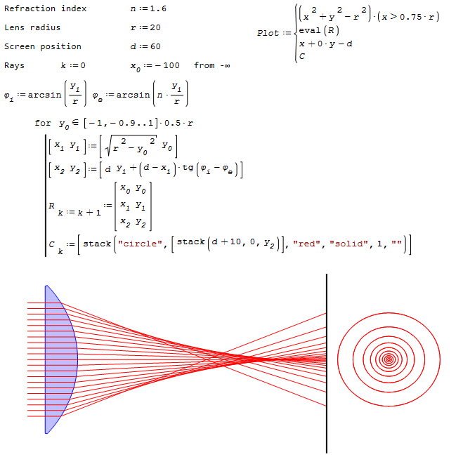

#11 Posted: 12/9/2024 10:44:48 AM
Valery Ochkov
Valery Ochkov
67 likes in 713 posts.

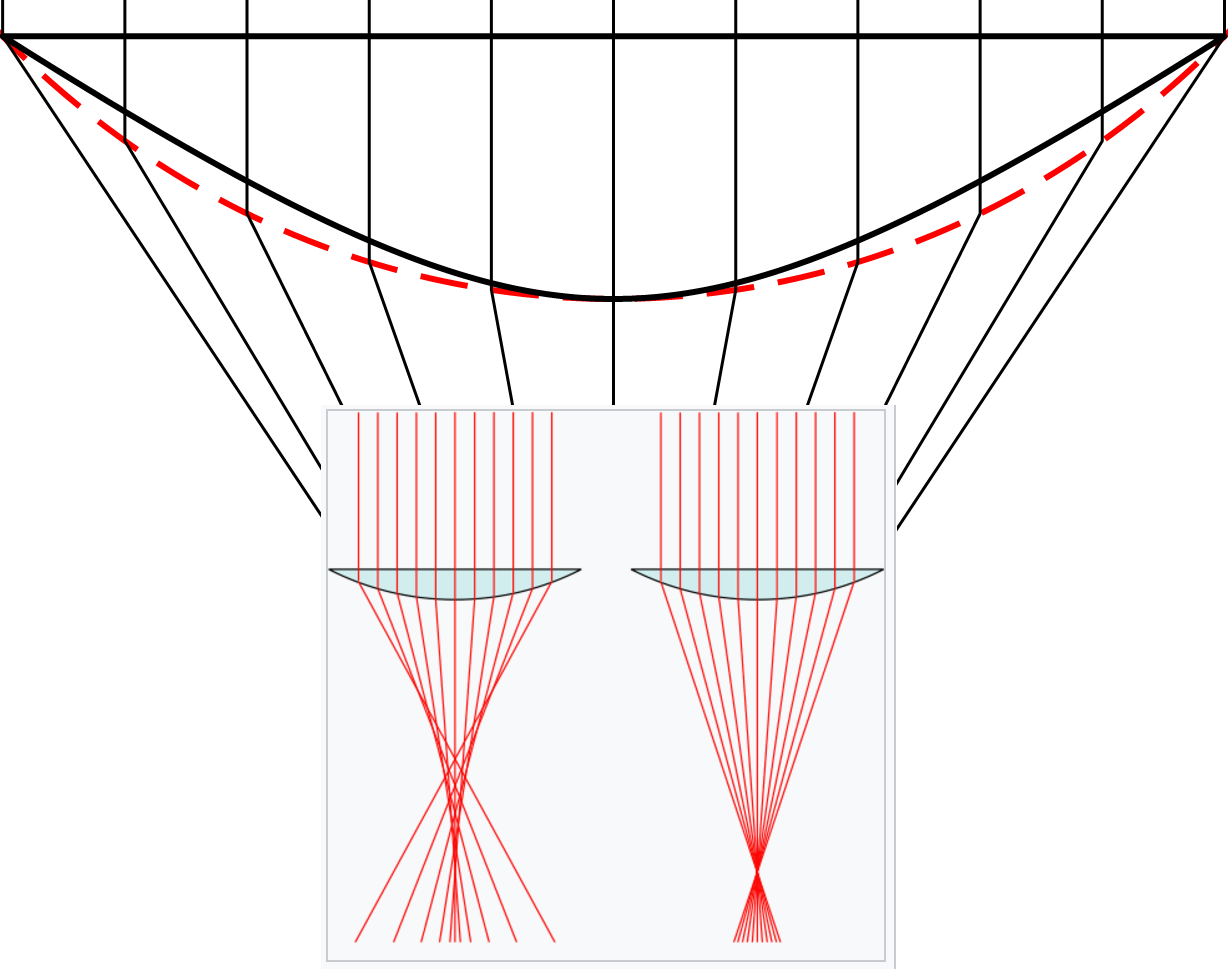

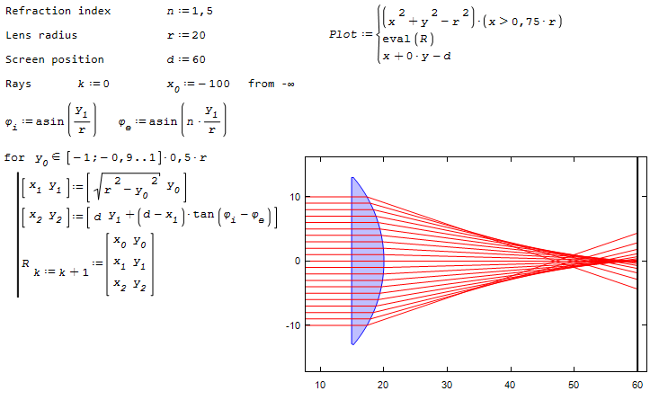

How to create this picture
https://en.wikipedia.org/wiki/Spherical_aberration
#12 Posted: 12/10/2024 4:11:05 AM
Hi Valery. This is a way.
spherical aberration.sm (15.88 KiB) downloaded 1778 time(s).
Oscar Campo 12/10/2024 9:43:00 AM, Valery Ochkov 12/10/2024 12:26:00 PM
#13 Posted: 12/10/2024 12:38:25 PM
Valery Ochkov
Valery Ochkov
Thanks!

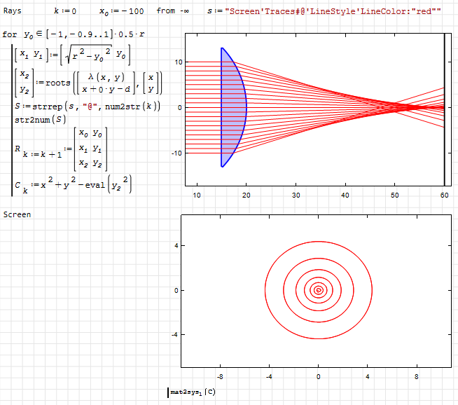

The last step
#14 Posted: 12/10/2024 9:21:41 PM
Hi. The screen. I also simplify a little the calculations.
spherical aberration.sm (26.41 KiB) downloaded 1925 time(s).
3 users liked this post
francesco rapuano 12/10/2024 11:05:00 PM, NDTM Amarasekera 12/10/2024 11:16:00 PM, Вячеслав Мезенцев 12/10/2024 11:19:00 PM
Very elegant solution
Alvaro 12/11/2024 6:18:00 AM

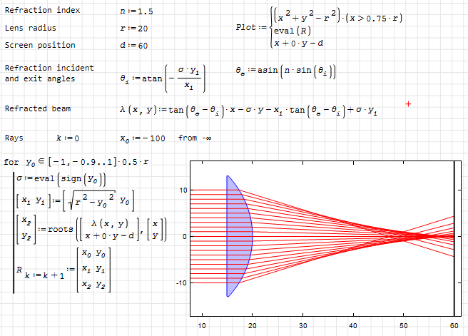

Root-free version of the spherical lens
spherical aberration_Kr.sm (12.37 KiB) downloaded 1706 time(s).
Oscar Campo 12/12/2024 6:29:00 PM, Alvaro 12/13/2024 7:27:00 AM
